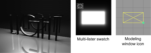

Render > Create Lights > Area
Creates a rectangular light source useful for simulating lightbox reflections.
Area lights are two-dimensional rectangular light sources. They are useful for simulating the rectangular reflections of windows on surfaces. An area light is initially two units long and one unit wide. Use Transform > Scale and Transform > Non-p Scale to re-size an area light.
The diffuse component of area lights is very small. To increase diffusion, move the light further away and increase its Intensity value. Area light shadows are much more costly than point light shadows. The increase in processing cost is proportional to the complexity of the scene and the size of the area light.
