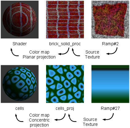

The Projection texture converts a two-dimensional texture or image file into a three-dimensional texture by projecting it in one or several directions. This is the same method used by the sMarble and sWood textures, so you can, for example, use scanned or painted image files with the Projection texture to create a variety of three-dimensional wood or marble textures. The Projection texture is also useful for converting a surface texture or image file to a solid texture to avoid texture distortion due to non-uniform surface parameterization.
