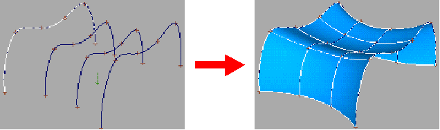

Lets you create a surface by “skinning” a NURBS surface across cross-section curves.

The U direction of the surface runs along the original construction curves. This option controls how the U parameters relate to the actual surface.
Uniform – The isoparametric curves corresponding to edit points on the original construction curves have integral parameters: the first edit point is parameter 0.0, the second is 1.0, and so on.
Arc Length – The new edit points for the curve are parameterized by the average length along the original construction curves at those points.
The starting edge of the surface has the parameter 0.0, and the opposite edge has the parameter equal to the average total length of the original construction curves.
The V direction of the surface runs between the original construction curves. This option controls how the V parameters relate to the actual surface.

Before building the surface, rebuild the other construction curves to match the parameterization of the first curve.
When using this option, make sure that the first curve you click has the parameterization you want for the new surface.

Automatically update the surface as curves are added.
This option changes the procedure for using the tool. When Auto Update is on, you must hold down Shift when you click more curves to add to the surface.
Save the history of the new surface for later editing. If you turn Create History on, when you modify the curves that were used to create the surface, the surface updates.
