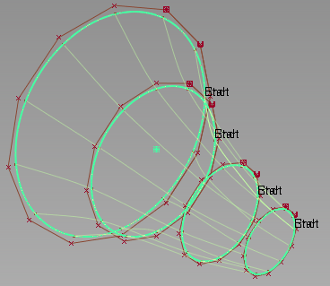

Use the Skin tool to create a surface by connecting a set of profile curves.
. The Skin Control box opens.
If Chain Select is on, G1 continuous curves are selected.
To remove the curve or curve set from the selection, click the curve again.
The surface is created after selection of the second curve, and is based on the parameterization of the first selected curve.
Output surfaces are grouped under the Skin node.
If Modify Range is selected, arrow manipulators appear on the skin surface at each curve or curve set.
If you select a curve or curve set, the selection is removed from the input and the surface is recreated.
Degree and spans of the surface are displayed in numerical fields of the Explicit Control option is selected.
Optional deviation displays between input curves and the surface.
If you modify explicit control degree and/or spans, the surface is refit to a new parameterization and the deviation display is updated.
If you modify the location of the range manipulator, the surface is fit to the new extent and the deviation is displayed between the extent of the surface and input curves.
If you select Undo All, the surface is removed.
If you select Next, you are prompted to select the first curve or curve set.
The tool creates a surface between the two curves.
