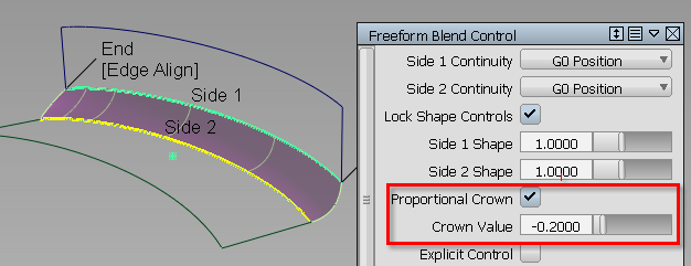

When building freeform blends with continuity set to G0 Position on both sides, the crown option lets you add small amounts of crown to the flat blends. Turning on Proportional Crown gives you access to the Crown Value slider. The slider ranges from -0.25 to 0.25, but larger values can be entered into the field. The crown value controls the height of the crown, and corresponds to a percentage of the distance between the two rails.
Position continuous freeform blend without a crown
Position continuous freeform blend with a crown value of -0.2
