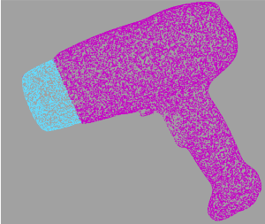

  4. After the region is completed, click Select in the lower right corner of the screen.
    The picked triangles are highlighted.

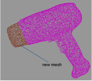

    • Press the Subset button to split off all selected regions and make them one new mesh object.
    • Press the Delete button to split off all selected regions and immediately delete them.
Once the mesh is subset into logical surfaces, each part can be assigned its own shader and material properties.
