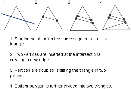

    Triangles along the projected curves boundaries are split to create the individual components (see diagram below).

    Once the mesh is partitioned, the split triangles cannot be fused back together to become one single triangle again, even after the logical surfaces are joined to create one mesh using the Mesh > Mesh Partitioning > Mesh Merge tool.
