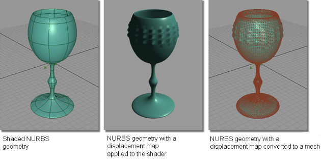

A mesh is calculated from the displacement map, and made active. The original object is made inactive, but remains in its original location. It may be obscured until it, or the mesh, is moved.
The example below shows NURBS geometry with a procedural displacement map applied to create a “hob-nail” pattern on the outside of the plastic waterglass. Using the Displacement Map to mesh tool, the displacement tessellation is used to develop a mesh.
In order to create a good, workable mesh from the displacement process, you can control the quality of the tessellation by adjusting the Mesh Tolerance and Displacement Detail parameters either from Render > Globals
, or from the option box of Mesh > Mesh Tessellation > Displacement Map to Mesh
