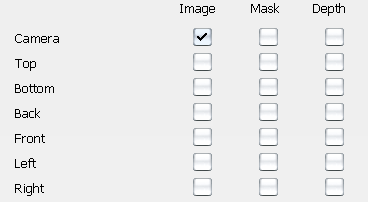

Camera Toggles
Determines whether a camera produces an image file, a mask file, or a depth file, or all three. You can select one camera only.
If all camera toggles are OFF when you do a render (Render > Render) or save an SDL file (File > Export > SDL), the following confirm box is displayed.
The renderer produces an RGB image (see Format). The default setting is ON for the perspective camera, and OFF (no image produced) for the orthographic cameras.
Mask
The renderer produces an 8-bit mask or matte file for use with compositing or paint software. If Mask is ON and the image file output Format is TIFF, TIFF16, RLA, or SGI, the renderer produces not a separate mask file but a four-channel Image file (RGBA). The fourth channel (A) represents the mask information. The default setting is OFF (no mask file produced) for all cameras.
Depth
The renderer produces a camera depth file (see Depth Format). The default setting is OFF for all cameras.
