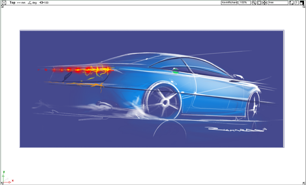

One of the easiest errors to make is to assume that what looks good on a high-resolution computer monitor will look good when printed on paper. Let’s assume you are using a default image plane resolution of 1268x770 pixels, established by sketching into a top view full screen, on a 19” monitor with a resolution of 1280x1024 pixels. As you will see, this resolution is very low for printing high quality large images on paper.

A default Alias image plane 1268x770 pixels when printed at 260 ppi results in an image size of 4.9” x 3”. The following image shows how the number of pixels per inch changes the size of the image on a piece of 11-inch wide paper.

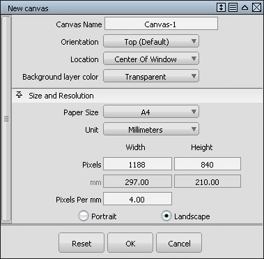

Select Canvas > New Canvas![]()
and set the number of pixels to suit the paper size and output ppi. Remember, you can save all Alias option preferences by selecting Preferences > User Preferences > Save Preference Set
ppi * height = number of pixels high the image plane should be (in inches).
ppi * width = number of pixels wide the image plane should be (in inches).
In this example we have chosen to create an image plane suitable for A4 paper at 4 pixels per mm.

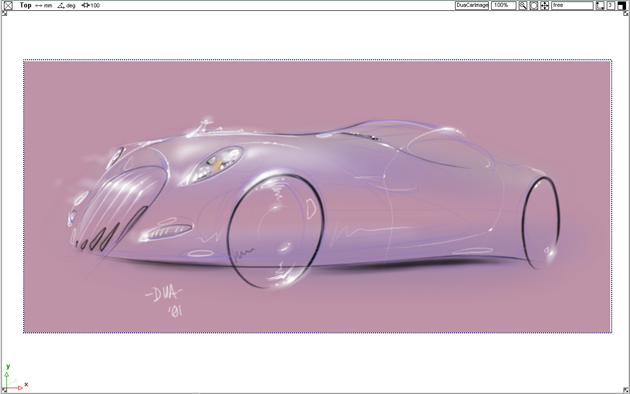

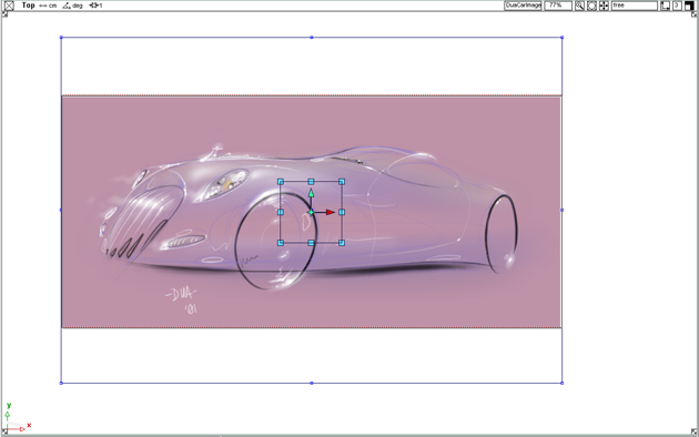

Sometimes when you’re sketching, you may find the image plane size is too small to fit the complete sketch.

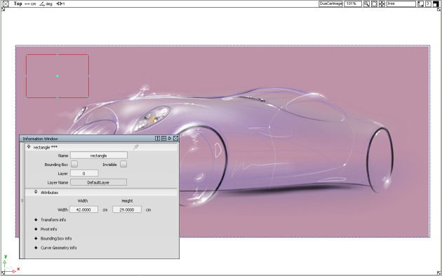

The resolution of the image plane can easily be corrected in one of two ways.

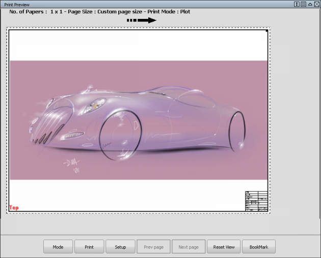

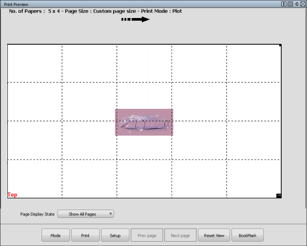

If the image plane looks too large or too small in the Print Preview window, you may need to resize it.

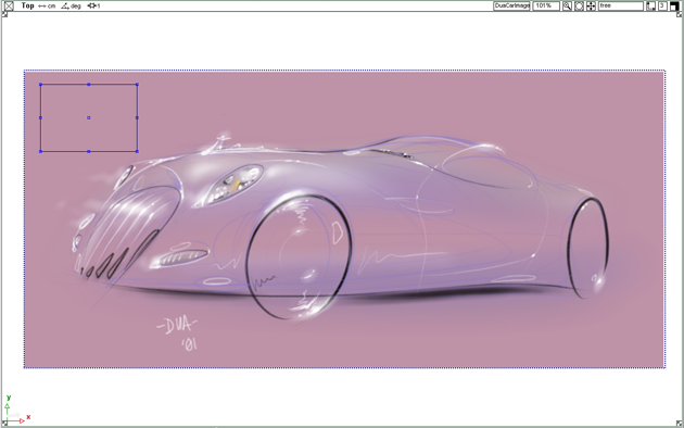

An Alias image plane exists in a 3D environment and its size is defined by the Alias units. During the early stages of design, you may just start sketching without considering printing size, but then find that it does not print at an appropriate size.
In this example, the width of the sketch is 274 cm; A2 paper size is 42 cm wide. In the Print Preview window, you can see that the sketch would require 20 sheets of A4 paper, as show in the following image.
As you scale the image plane the ppi (pixels per inch) dynamically changes but the total number of pixels on the image plane remains the same.
No data is added or removed from the image plane by scaling or transforming the image plane.
Scaling planes and layers produces different results. When an image layer is transformed new pixel information is added or removed and the image layer resolution is changed.

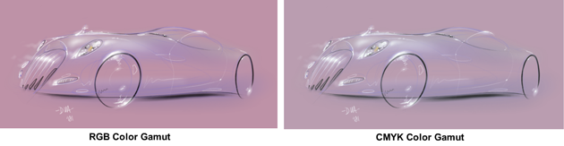

The final issue with printing is the color perceived by the naked eye and the representation of the color on different monitors, paper types, and inks. Monitors are RGB output devices and the range of colors, saturation, and contrast they can display is often very different to what a printer can print. Sketches, when presented on the computer, often display strong dynamic colors that cannot be printed using process inks. Generally, most monitors are able to display over 16 million colors. When printing on a press in CMYK, the range is usually quoted as under 20,000 distinguishable colors.
To help you understand the differences between monitor and paper, Alias supports a print preview option for CYMK. This converts the colors from your sketch into the color gamut of your output devices.
Here is an example of a simple sketch in RGB color space compared to CYMK color space.
To add to the complexities of printing in color, each paper type also has its own color gamut that it can display. For more information about paper types, see the manufacturer’s web page or information booklet.
