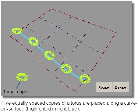

    The tool places a copy of the targets on each surface locator point, and, by default, one duplicate on each curve selected. Continuous sequences of curves are treated as one destination.
    The target copies are oriented so that their local Z-axis is aligned with the surface normal at the point where they are placed.

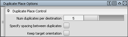

  6. Double-click the tool to open the option box.
  7. Adjust the number of copies and spacing in the option box.

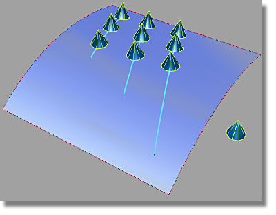

In the example below, a cone primitive, made up of two surfaces, is selected as the target. The three curves-on-surface are selected together as the destination curves for this setup. After accepting the input, the Duplicate Place tool makes three copies of the cone for each destination curve, and places them on each curve. The Specify spacing between duplicates option is turned on and a distance specified, so the nine cones are placed in a neat 3x3 arrangement.
