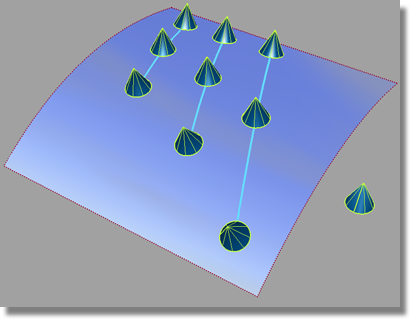

Num duplicates per destination
The default is 1 on each destination. This value is the maximum number of duplicates desired on each destination curve. Depending on the surface, fewer copies may be placed. The field Max num duplicates placed successfully shows the maximum number placed on any one particular curve.
Specify spacing between duplicates
When this option is turned on, the tool attempts to place duplicates along the curve while maintaining the Spacing between duplicates distance between them.
If the curve is too short for the specified number of duplicates, given the spacing specified, the extra duplicates are not placed. If the curve is too long, the number of duplicates is respected, and the extra length of the curve remains empty, as seen in the following image.
When this option is turned off (default), the tool takes each curve and places the specified number of duplicates equidistant to each other. In this way, the spacing is different for each curve, as seen in the following image.
This option is only available when Specify spacing between duplicates is turned on.
The spacing is measured as the arc length along each curve, between the contact points of two consecutive target copies. The contact point of a target is defined as the midpoint of the bottom face of its bounding box.
This field is read only , where the tool reports back on the maximum number of duplicates that fit on any one of the destination curves.

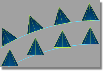

Keep target orientation
If this option is on, the duplicates are not rotated to fit the surface normal (or free curve tangent). Instead, they retain their original orientation. In the image below, the top version is the default behavior (option turned off), where the target cones are rotated to match the surface. The bottom version is with the option turned on, and the cones retain their original orientation.
