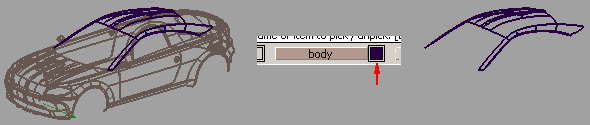

  2. You can see the whole car. All but the surfaces corresponding to the greenhouse (the roof, the A pillars and the B pillars) are in the layer named body and that layer is in Reference state. Click on the square on the right of the name of the body layer in the layer bar to make this layer invisible.
    We only need to work with the surfaces of the greenhouse.

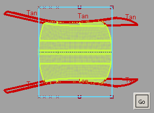

  5. Use the and draw a pick-box around the middle surfaces as shown in the figure, and click Accept Targets to select the roof surfaces as target geometry in the rig.
  6. Click the Add Constraints tool in the Transformer Rig toolbox, and select the remaining surfaces on both sides of the roof. Click Accept Constraints to add these surfaces as constraints in the rig.
    The word Tan means the constraints are all tangential constraints. The pale green dots that appear inside the target surfaces are part of the clamp visualization, and the color indicates that the target surfaces are free to be modified in the current rig.

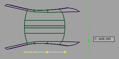

  2. Choose Transform > Move, and using the , drag the curve down to below the A pillar, as shown in the figure. Leave the curve picked.

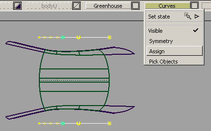

  5. Choose Layers > New to create a new layer. Name the layer Curves.
  6. Assign the two curves to the Curves layer.

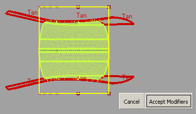

  11. Choose the Add Free Modifiers tool from the toolbox, and click on the skin surface to select it.
    Click Accept Modifiers to confirm.

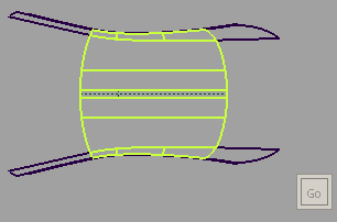

  12. Click Go. A popup window may appear to notify you that the Transformer Rig history has been set up. If so, click OK to continue.

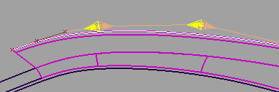

  5. Click the Transform CV tool. Under mode, choose SLIDE.
    Orange and yellow arrows appear beside the selected CVs.
  6. Using the , click one of the yellow arrows in the modeling window. Drag the mouse towards the left, and notice the modifier surface becoming "flatter". Continue to slide the CVs until the leftmost arrow touches the next CV to the left, as shown here:
