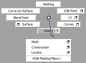

    The mouse button marking menu appears at the location of the mouse pointer.
  3. Keep the mouse button held down and drag out toward a tool name. A thick black line shows the direction of the mouse pointer.
  4. Release the mouse button to choose the highlighted tool.
