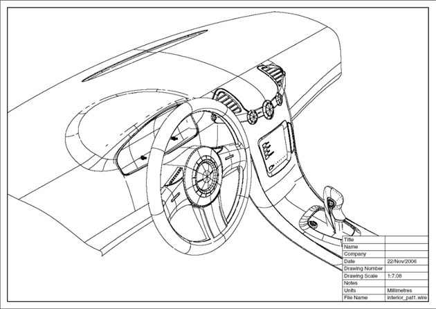

Whether to show the information box on the output.
The information that will appear in the information box.

The layout of orthographic and perspective windows in the output.
