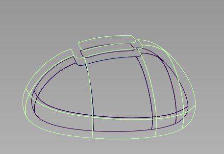

When offsetting curves, the curves are grouped based on topology, and an arrow lets you choose the direction of the offset for each group, so that all curves in a group are offset in the same direction, regardless of their initial orientation.
Offset several curves in the same direction simultaneously
Curve sets are created based on topology. Each set shows an offset preview of a different color with an arrow indicating the unified direction of the offset.
The Topology Distance (in Preferences > Construction Options) is used to determine which curves form a unified set that must be offset in a single direction.

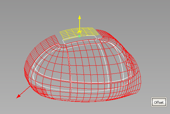

When offsetting surfaces using Object Edit > Offset
, the surfaces are grouped based on topology, and an arrow lets you choose the direction of the offset for each group, so that all surfaces in a group are offset in the same direction, regardless of their initial orientation.
(See Normals and surface orientation for more information on surface orientation).
Offset several surfaces in the same direction simultaneously
Surface sets are created based on topology. Each set shows an offset preview of a different color with an arrow indicating the unified direction of the offset.
The Topology Distance (in Preferences > Construction Options) is used to determine which surfaces form a unified set that must be offset in a single direction.
The offset preview updates.
The offset surfaces are created and grouped.
