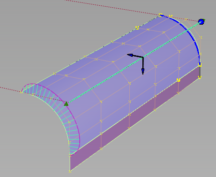

Displays the imaginary wall that is used in the calculation of the fillet.
Choose whether to have the surfaces automatically trimmed, or just to place the curves-on-surface.
Choose whether to get visual feedback about continuity (set in the Fillet section). Green indicates success; yellow indicates that the continuity condition has not been met.
If this box is checked, selecting a surface curve also selects all other surface curves that are tangent continuous with it.
You can specify whether a fillet surface needs to be extended along the rail to reach the boundary of the input surface at each end of the rail. To toggle an extension at a rail end, click the green arrow appearing at that end. The arrow is shown in light green when extension is on. If the rail is closed, that is, its endpoints coincide, extension is not useful, and, therefore, the arrows are not shown.

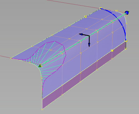

The variable parameter (Radius, Flange angle, or Flange length — as specified by Variable in the control window) is controlled using a set of manipulators in the modeling window. Only one of the parameters can be varied: the other two are held constant.
Each manipulator consists of two handles — the rail slider and the value handle — only one of which can be active at a given time. The active handle is shown in light blue. The rail slider, a "ball" sliding along the rail, indicates the position on the rail where the value applies. The value handle, an approximate cross section of the future surface, controls the value of the parameter at this point.
The value of the active handle is shown on the prompt line.
