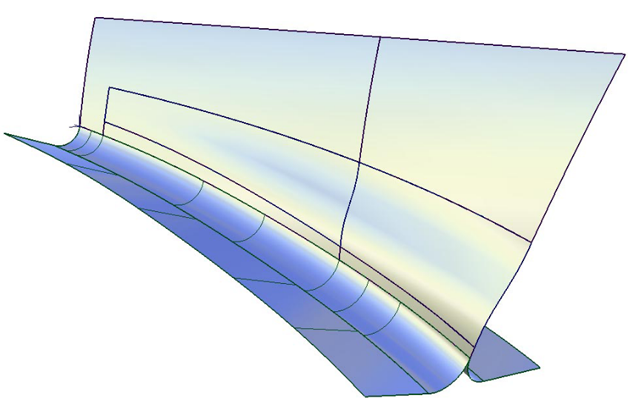

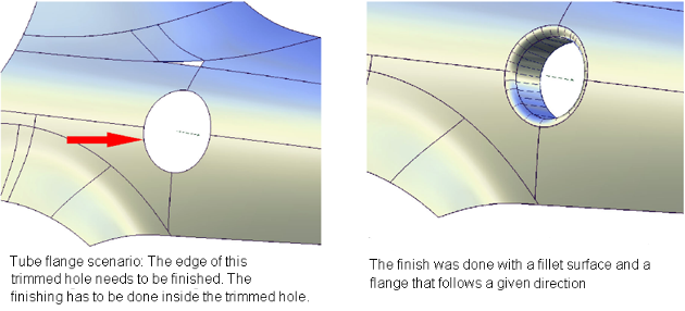

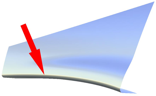

These two examples identify the two main cases for finishing surface edges. For the first case, there is a pre-defined contact line where the edge finish (consisting of a fillet and flange) needs to be added.
For the second case, a pre-defined silhouette line controls the creation of the fillet.

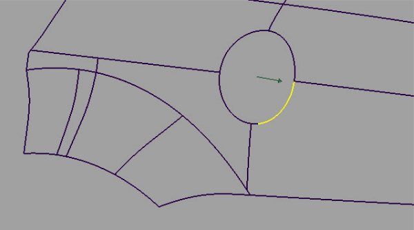

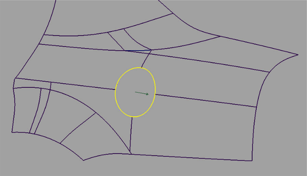

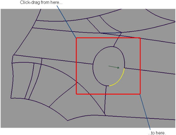

The curves forming the edge are selected.
After the edge is selected, you can select vectors to define the flange when the parting line method is used.

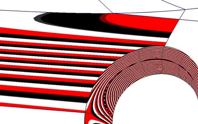

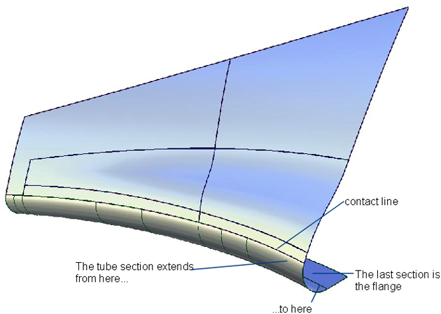

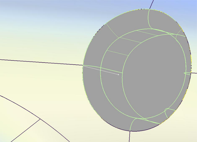

The Tube flange tool provides a solution for an edge finish where the focus is on the contact line. The contact line defines where the tube touches the main surface. It is important for aesthetic reasons to control the line where a highlight is changing. To do this, the Tube flange tool ensures that the new tube is added at the selected geometry.

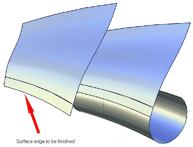

To create a tube

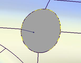

The Tube flange tool creates a tube touching the selected geometry (curves-on-surface, iso-parametric lines, or surface edges).

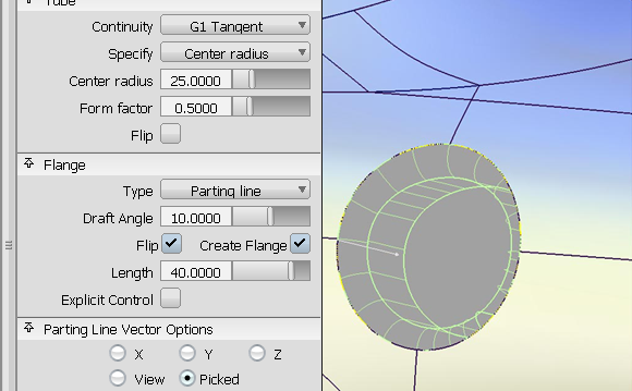

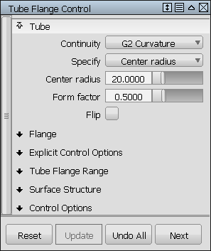

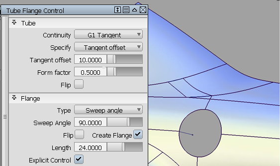

The tube has parameters that can be modified in the option window.

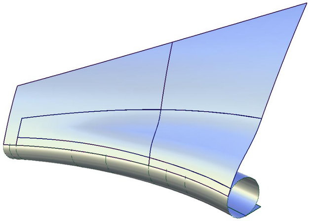

If you create a tube with G1 Tangent continuity, the tube is created with 360 degree sections. It will be trimmed to an appropriate section when creating the flange.
If you create a tube with G2 Curvature continuity, the tube will lose the 360 degree section, and be created between the contact line and the flange.

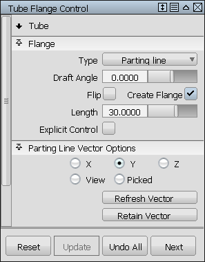

There are two methods to calculate the flange at the end of the tube section. They are:
Based on a vector (selected by clicking it with the left mouse button, or specified through the option window), the tool analyzes the parting line and creates a linear extension called a flange.

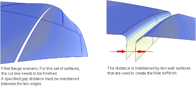

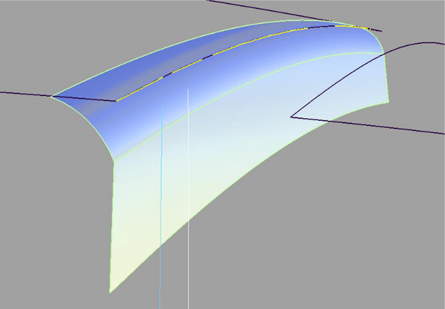

Use this tool to control the silhouette line of an edge finish.

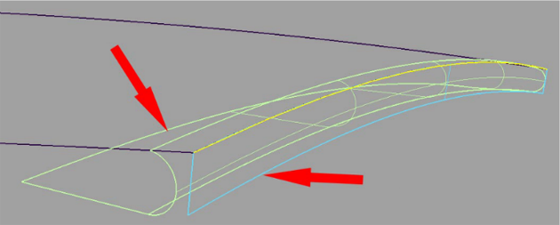

When creating cut lines on a model, there is usually a certain predefined distance of the cut. To maintain this distance, the Fillet flange tool first creates a wall. This wall controls the appearance of the fillet and can be used to define the distance between two fillet flanges to create a cut line. This imaginary wall is used to help define the silhouette of the edge finish.
To create a fillet
The wall is a temporary surface (shown in blue above) that is used to create the fillet surface . You can see it by turning on Show Wall in the Control Options. After you have finished constructing the fillet flange and exit the tool, the wall becomes invisible.

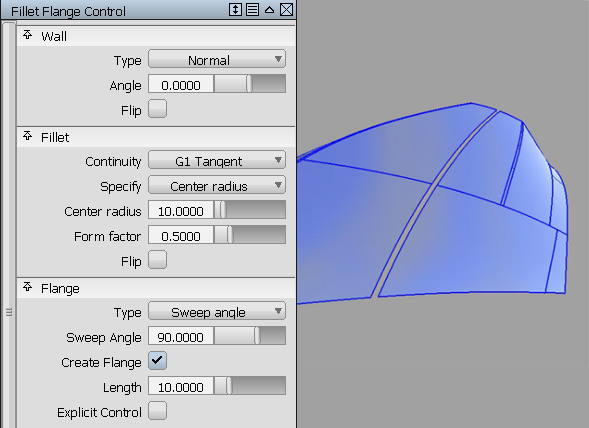

Now that you’ve got the wall in the right place, you need to create the fillet.
At the end of the fillet, the tool creates a linear extension called a flange. The tool uses the same method as described in the section for the Tube tool.

The variable parameter (radius, flange angle, or flange length — as specified by Variable in the control window) is controlled using a set of manipulators in the modeling window. Only one of the parameters can be varied: the other two are held constant.
