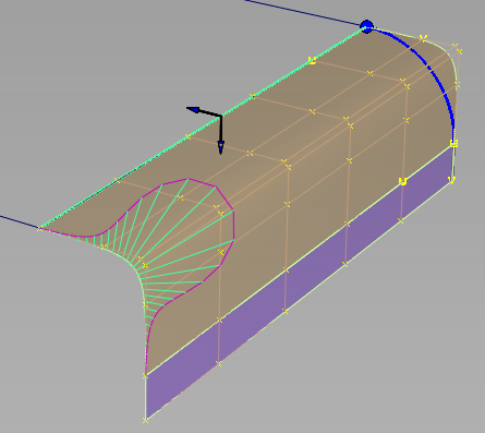

This parameter lets you adjust the shape of the tube while keeping either the Center radius or Tangent offset constant. It specifies the ratio between the lengths of the innermost and outermost CV arms of the hull in the V direction of the tube. Possible values range from 0.1 to 2.0.
In the example below, we specify the tangent offset to be 60.0. Changing the form factor causes the center radius to vary.
Form factor set to 0.1, creating a small center radius and a sharper bend in the tube.
Form factor set to 2.0, creating a large center radius and a more circular tube shape.

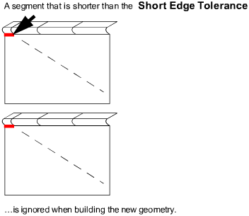

In the case of cross-knot insertion, the system will not allow spans of a linear distance less than the Short Edge Tolerance.

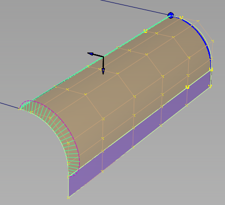

The variable parameter (Radius, Flange angle, or Flange length — as specified by Variable in the control window) is controlled using a set of manipulators in the modeling window. Only one of the parameters can be varied: the other two are held constant.
Each manipulator consists of two handles — the rail slider and the value handle — only one of which can be active at a given time. The active handle is shown in light blue. The rail slider, a "ball" sliding along the rail, indicates the position on the rail where the value applies. The value handle, an approximate cross section of the future surface, controls the value of the parameter at this point.
