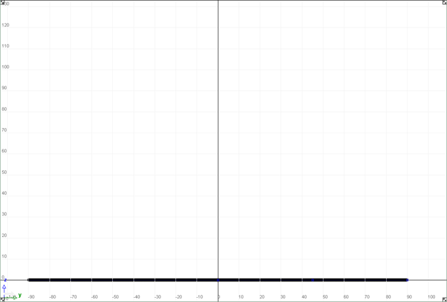

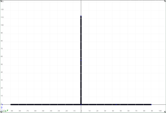

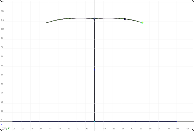

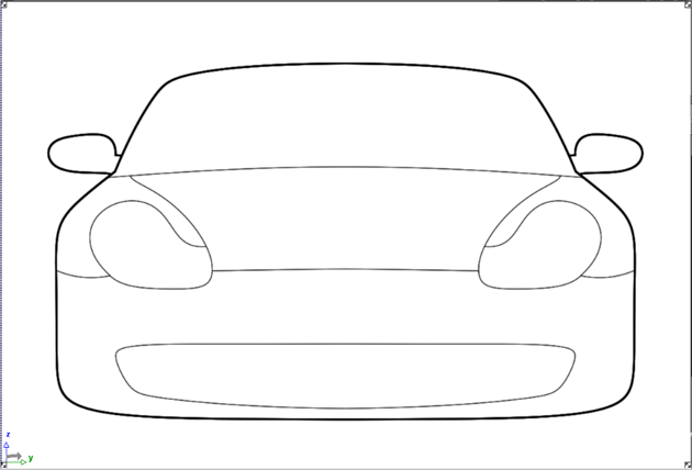

  4. Open the Curves > Blend Curve Toolboxand choose the Keypoint Curve Tools > Lines > Line tool. Place the first point at 0,0,0 and the second point at 0, 90 cm, 0. Notice how the shape is automatically drawn on the left side of the construction plane. Using the object information window you can adjust the line length to accurately define half the width of the car.
  5. Select the Line tool again and draw another line to define the height: 0, 0, 112 cm.
    Note:
    You might need to zoom out your view to see the whole lines.
  6. Select both lines and adjust the width of the shape outline. I.e make these construction lines 2 pixels wide (Width set to 2.0). This will also modify the width of future construction lines that you place in the image.

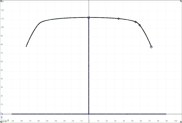

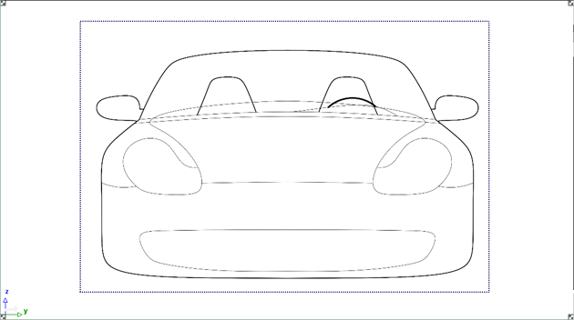

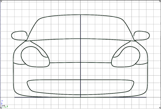

  7. Open the Blend curve toolbox from the Curves palette, choose Blend curve create and use curve snap to snap the first point to the top of the vertical line you created earlier. Continue drawing the windscreen profile. Notice that as you draw on one side of the symmetry plane, the system draws the curve and the shape on the other side.
  8. Use the blend curve tools to edit the curve and add constraints as required. For example, the center point requires a tangent constraint to ensure the curve is flat across the line of symmetry.
  9. Continue to create additional blend curves to define the front view. Make sure you use curve snap for curves that intersect so a curve relationship/constraint is automatically created.
  10. Now select the curves you want to make wider and modify the Shape Outline Width.
  11. You may also want to remove the outline from the first horizontal & vertical lines. These were created as guide curves to establish the correct width & height of the car.

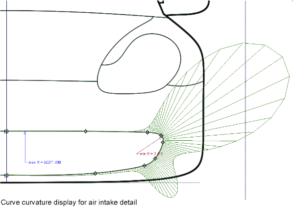

  12. At this point you may wish to evaluate the quality of each curve created using the Alias curve curvature tools.
  13. At any time you can toggle off the geometry curves using F12 or WindowDisplay > Toggles > Model.

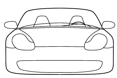

  14. If you are working in an environment with 1:1 projection capabilities or you want to print your tape drawing at a larger scale, you may want to increase the resolution of the canvas plane. All shape curves will automatically update when the canvas plane resolution is changed.
  15. Our canvas plane resolution is 1109 * 770 pixels, which if printed at 150ppi would result in an image printed on paper of approximately 7” x 5” without any image scaling.

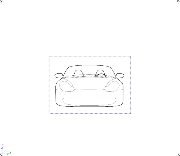

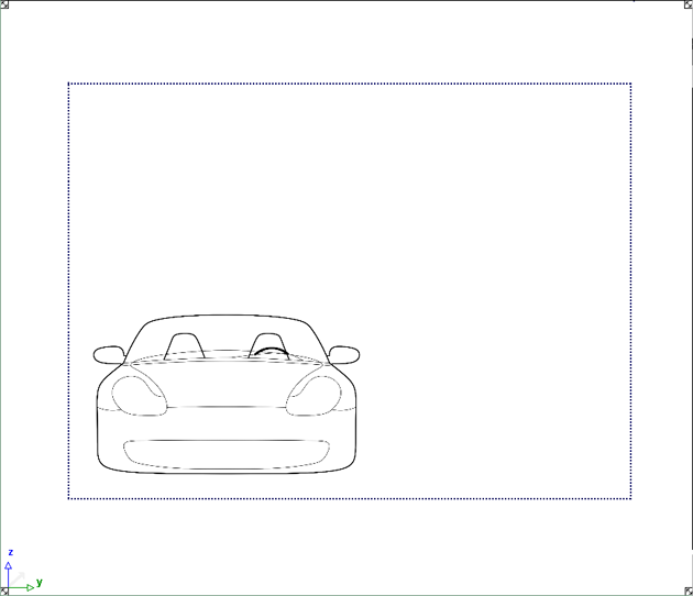

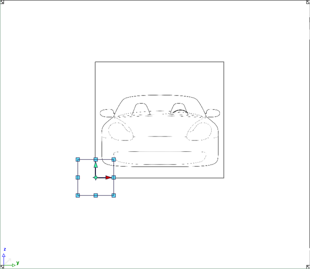

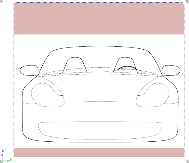

  1. First, dolly out to see the canvas plane and enough space around it to be able to see the edges of the new canvas plane.
  2. Open Canvas > Resize Canvas to open the Resize Canvas Control window. Adjust the canvas Width to 2000 pixels and the Height to 1800 pixels.
  3. The canvas plane by default enlarges from the center of the canvas plane. The blue dashed line shows the new canvas plane size.
  4. We need to scale the canvas plane to suit the size of the curves we have drawn earlier. First choose the canvas plane in the Construction Plane Editor. Then choose Canvas > Resize Canvas and drag the corner selection handle to increase the size of the canvas plane to be large enough to encompass all curves. Notice that the shapes automatically re-render to a new image resolution every time the canvas plane is transformed.
  5. The canvas plane is still a little too tall. Choose Paint > Select > Marquee(rectangle) and select the area of the canvas plane to keep.
  6. Now choose Canvas > Crop to Marquee to reduce the canvas plane size. Note the marquee tool and crop can also be used to make a canvas plane larger.
  7. Notice the shape outline now look much smaller because the canvas plane resolution has changed. Adjust the width of each shape curve to suit the new resolution.
  8. The image below now has a canvas plane resolution of 2000 x 1325 pixels, which prints approximately 13.25” x 8.75” @ 150ppi. Alias supports canvas plane resolution up to 6000 pixels and also support bi-linear image scaling during the printing process so much larger images can be printed.

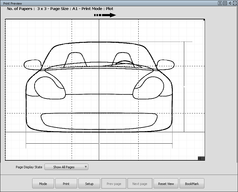

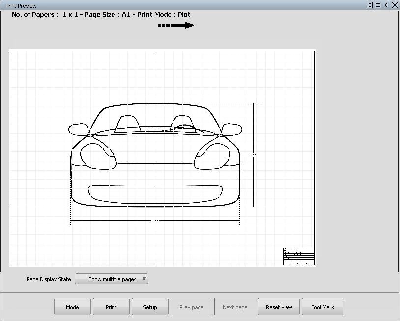

  5. Now it’s time to select the print menu command to open the preview window.

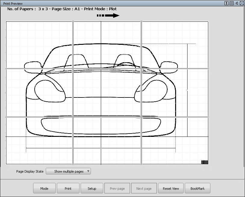

    The print preview window shows dotted line pages. At a scale of 1:1, this image requires 9 pages of A0 size paper.
  6. Modify the Page Display State in this preview window to display each page with paper margins. This option makes it clear to understand what will be printed on each page.
    Note:
    You can use standard Alias view modifier keys ( + + (Windows) or + + (Mac)) in the preview window to adjust exactly how the image will be positioned on the paper.

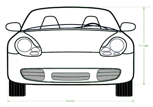

Adding Simple Texture To a Tape Drawing

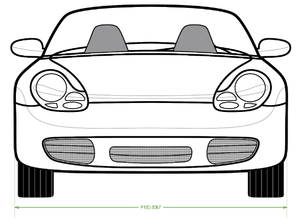

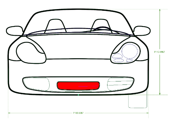

When creating a tape drawing, designers often add solid color and texture to improve the appearance of the image. In this example we will use the Make Shape tool to add this detail.
  1. Load in your tape drawing file you created earlier. In our example, the main tape curves have been created and additional curves that define the wheels, headlights, and grill detailing have been placed with a thinner line.

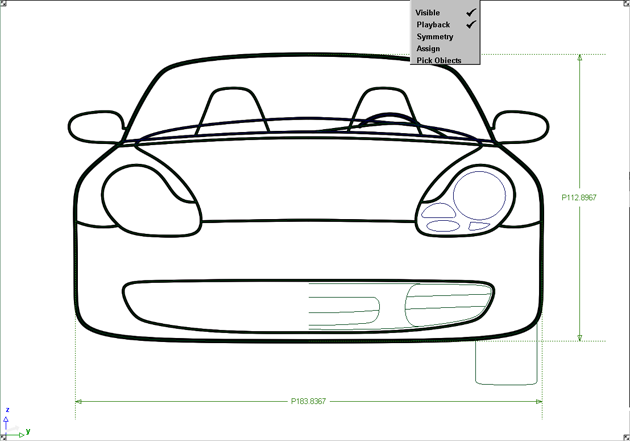

    At the moment the additional curve detailing is assigned to the default 3D geometry layer, so we need to create new symmetry layers and assign the geometry to them.
  2. Choose Preferences > Workflows > Modeling to make all modeling tools available.
  3. Choose Layers > New to create a new geometry layer. A geometry layer will be added to the horizontal bar. Double click the new layer and type a name, for example, Headlights.
  4. Repeat this step and name the next layer Tires; repeat again and name the next Grill. The Grill geometry layer should be the active layer (drawn in yellow).
  5. Using Pick > Object select the curves that define the grill detailing and assign them to the Grill layer using the Grill layer drop-down menu.
  6. Using the same menu, turn on Symmetry for this layer and notice how the curves are reflected across the center line.

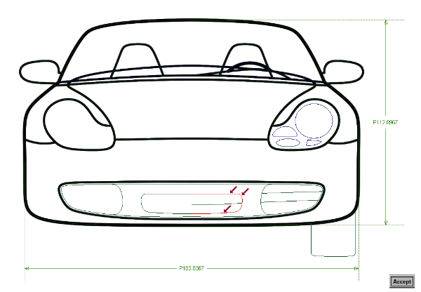

  7. Choose Paint > Shape > Make Image Shape and select the curves that define the center grill. Note you need only select one half of the grill curves.
  8. Click the Accept button. After the curves are accepted a shape object is created and the paint parameters adjusted.

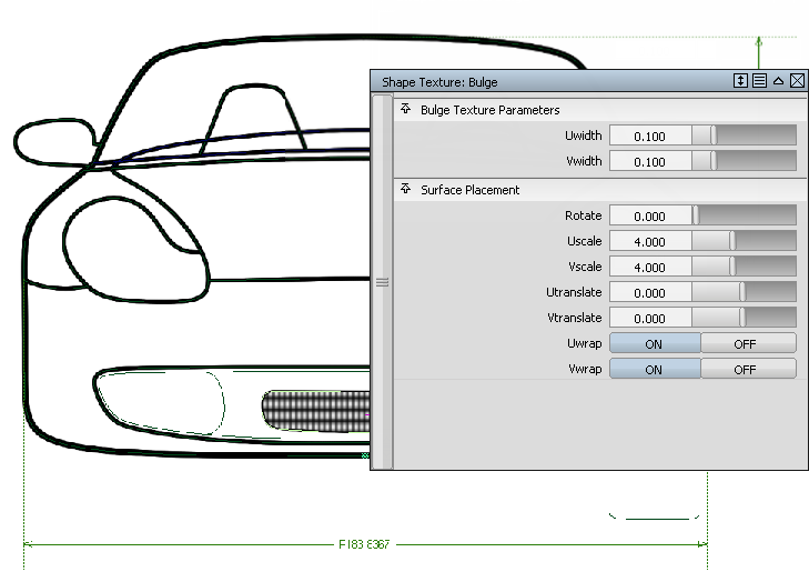

  9. In this example, we want to create a small vertical grill effect, so click on the Map button next to RGB Color in the Shape Fill options of the Paint Panel to open the Shape Texture window.
  10. Click the Bulge texture.
  11. Adjust the Uscale & Vscale bulge parameters .
  12. Repeat this process for the outer grill detailing.
  13. Follow the same procedure to assign the Grid texture to the tires. Set the Vwidth to 0 so the grid displays as vertical lines.
Congratulations! You’ve now completed a tape drawing using Alias.
