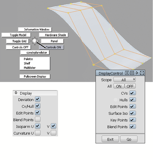

To use Alias effectively, you need to become accustomed to toggling on and off the display of certain elements. This is particularly true of Control Vertices (CVs). These points reveal the mathematics of the geometry and provide a powerful method for sculpting geometry.
Master display controls are located in ObjectDisplayControl. This control window provides check boxes for turning the various controls on and off.
You will find that it is easier to access these controls in the Marking Menus and the Control Panel.
To pick Control Vertices (CVs), use Pick CV from the palette or from your Marking Menus. The pick behavior is the same as that of picking objects, so you can click to select or marquee select multiple CVs.
