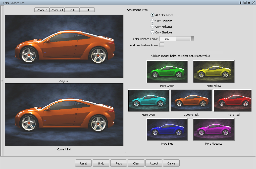

  1. Import the image (File > Import > Canvas Image) or pick the layer to be adjusted in the Canvas Layer Editor.
  2. Choose Paint Edit > Color Correction > Color Balance. The active layer is loaded into the Color Balance window.

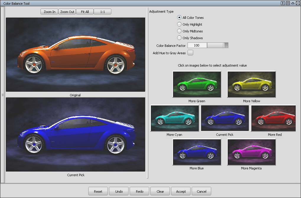

  3. First we change the Color Balance Factor slider to 100%. This shifts all hues to pure color but maintains the current saturation and value (shading range). Note how the thumbnail icons change to preview the possible color balance changes when you click the thumbnail.
  4. Click the More Blue thumbnail and watch the preview window update to the current adjustment value as shown below.

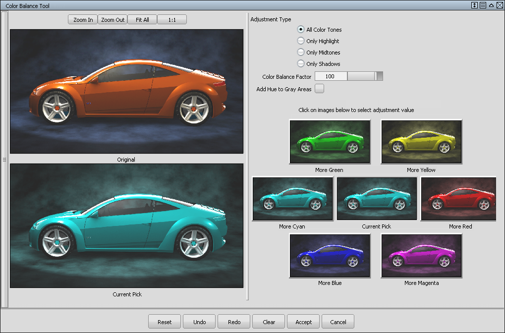

  5. Now click the More Cyan thumbnail and watch the preview window update to the current adjustment value. Also note the rear orange indicator light has changed because no mask layer or selection mask was used.

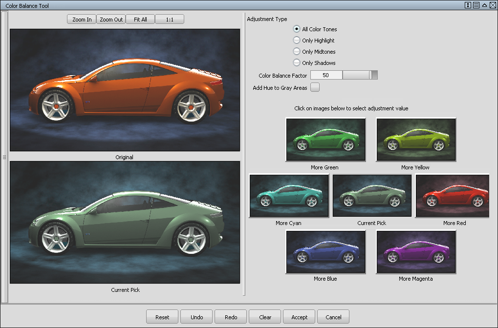

  6. The hue looks very strong, so click Clear at the bottom of the window to restore the original image.
  7. Adjust the color balance amount to 50% and click on the More Cyan thumbnail. This now adds 50% cyan to the original image. If you click the thumbnail again, it will add more cyan to the current selection.
The color balance window encourages experimentation with color balance, so play and have fun: when you are pleased with the preview, click Accept and the current adjustment values are applied to the active image layer.
