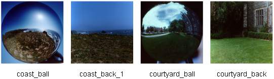

Image based lighting offers additional realism through the use of high dynamic range images (HDRI) as environment maps, and the treatment of that environment map as a source of light, not just a reflection map.
Image based lighting takes reflection maps a step further into realistic rendering by replacing the standard 24-bit reflection maps with High Dynamic Range images. HDR images include more lighting data than a standard 24-bit image does. This information can be used effectively in environments to capture the bright and dark areas of the environment in not only reflections, but in the specular highlights, diffuse component, and all other components of the shader.
HDRI images are environment maps, and may be spherical (latitude/longitude maps) or cube environment maps stored as vertical cross images, which have an aspect ratio of 3:4 (width to height).
HDR images can be created using Photoshop CS2, HDRIshop, or purchased; some are available on the web, as well (try searching for “royalty-free HDR images”).

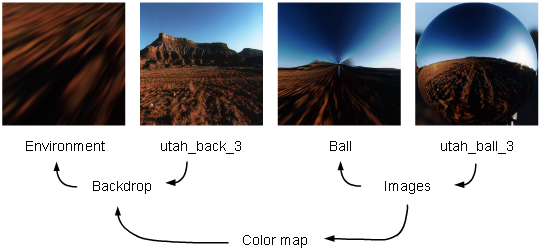

The Ball texture uses an image (or series of images) of a highly reflective chrome ball in an environment (real world or computer generated) to re-create that environment. This is possible because the reflections in the chrome ball provide a (nearly) 360 degree view of the environment.
A Ball texture background renders faster than a procedural texture background or a background modeled with surfaces. You can therefore replace a complex background with a Ball texture (by rendering an image of a chrome ball in that environment) to reduce rendering times.
In order to use the Ball environment texture, you must map the texture’s Image parameter with the image of a reflective chrome ball in the environment you want to re-create. You should also map the environment’s Backdrop parameter with the image of the environment without the chrome ball.

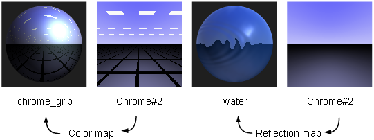

The Chrome texture simulates a showroom environment. The texture consists of a ground plane and a sky plane (with fluorescent style light rectangles), and provides a simple but effective environment to simulate reflections off chrome surfaces.

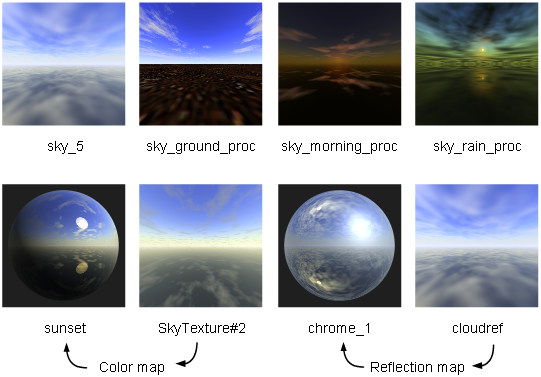

The Sky texture simulates a planetary environment viewed from the surface of a planet.
If the eye point or view drops below the floor, the Sky texture swatch in the Multi-lister turns red as a warning. If you render the scene, the floor appears red. Make sure that the eye point is always above the floor (the ground plane).
