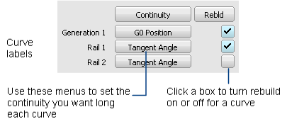

In the option window of the tool you used to create a surface, use the pop-up menus next to the names of the generation and rail curves to choose what level of continuity the surface should maintain with its neighbor along that edge.

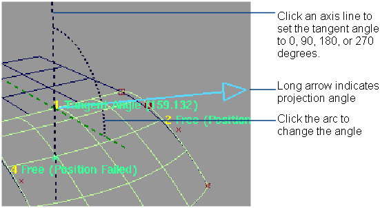

Set a manual tangent angle along an edge
  1. In the option window, set the continuity for the edge to Tangent Angle.
  2. Use the tangent angle manipulator to set the angle.
How do I use the tangent angle manipulator?
