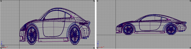

Use the View > Set Non Proportional View
tool to scale the view independently along the horizontal and vertical axes in both orthographic and perspective windows. This can also be thought of as changing the aspect ratio of the view.
This results in the model appearing squished or stretched, which may help reveal curvature problems.
You can use this tool in two different ways:

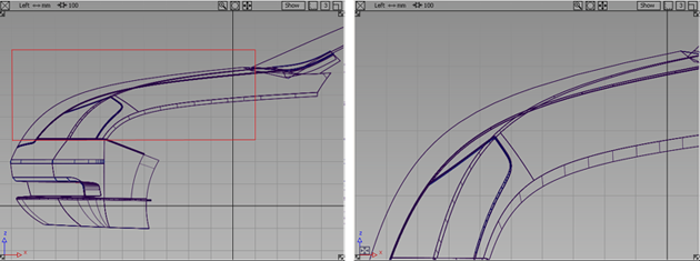

When you release the mouse button, the window fills with the content of the box. This happens whether you drag right or left.

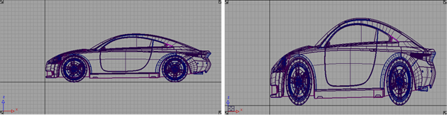

Once you have created a non-proportional view with View > Set Non Proportional View
, you can use View > Toggle Non Proportional View
to switch back and forth between your non-proportional and proportional view. No other aspects of the camera view are changed when using this tool.
A Non Proportional View icon
is displayed in the lower left hand corner of the window when the view is non proportional.
