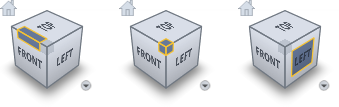

Reorient the view with ViewCube
Use ViewCube to reorient the current view of a model. You can reorient the view with the ViewCube tool by clicking predefined areas to set a preset view as current, click and drag to freely change the view angle of the model, and define and restore the Home view.
Switch to a preset view
The ViewCube tool provides twenty-six defined areas you can click to change the current view of a model. The twenty-six defined areas are categorized into three groups: edge, corner, and face. Of the twenty-six defined areas, six of the areas represent standard orthogonal views of a model: top, bottom, front, back, left, and right. Orthogonal views are set by clicking one of the faces on the ViewCube tool.
Use the other twenty defined areas to access angled views of a model. Clicking one of the corners on the ViewCube tool reorients the current view of the model to a three-quarter view, based on a viewpoint defined by three sides of the model. Clicking one of the edges reorients the view of the model to a half view based on two sides of the model.
To reorient the current view to a preset orientation
  • Click one of the edges, corners, or faces on the ViewCube tool.

Switch to a custom view
You can also click and drag the ViewCube tool to reorient the view of a model to a custom viewpoint other than one of the twenty-six predefined viewpoints. As you drag, the cursor changes to indicate that you are reorienting the current view of the model. If you drag the ViewCube tool close to one of the preset orientations and it is set to snap to the closest view, the ViewCube tool rotates to the closest preset orientation.
The outline of the ViewCube tool helps you identify the form of orientation it is in: freeform or constrained. When the ViewCube tool is in freeform orientation, not orientated to one of the twenty-six predefined views, its outline displays dashed. The ViewCube tool is outlined in a solid continuous line when it is constrained to one of the predefined views.
To interactively reorient the view
  • Click the ViewCube tool, hold down the , and drag in the direction that you want to orbit the model.

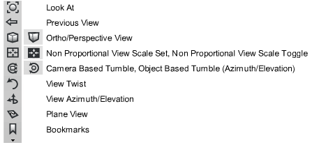

Display the NavBar
The NavBar is available for use when the ViewCube is selected as the View control in the Viewing section of Preferences > General Preferences.
To display the NavBar
NavBar Tools
Of special interest are the following tools:
Look at
Clicking the Look at icon centers the view and zooms in on the selected objects (or all objects if nothing is picked). See also Center the view on specific objects.
Previous View
Return the view to the previous view.
Ortho/Perspective
Switch between orthographic and perspective views. A label below the ViewCube indicates when the view is orthographic.
Non Proportional View Scale Set
Scale the view independently along the horizontal and vertical axes. After you click this tool, the interaction depends on the setting of Non proportional scaling box in General Preferences.
If this option is checked on, click and drag to draw a box on the screen around the area you want to examine. When you release the mouse button, the window fills with the content of the box.
If this option is unchecked, drag the mouse to scale the view interactively. Drag the left and right to scale the view horizontally, and up and down to scale the view vertically.Drag the to scale the view horizontally only. Drag the to scale the view vertically only.
See Scale a view non-proportionally.
Non Proportional View Scale Toggle
Switch between proportional and non-proportional views. See Toggle between proportional and non-proportional views.
Camera Based Tumble
Lets you track, dolly, and tumble the view using different mouse buttons. Press + (also + on the Mac) and drag the mouse button as follows:
: Tumble
: Track
: Dolly
Object Based Tumble (Azimuth/Elevation)
Lets you revolve, track, dolly, and twist the view using different mouse buttons. Press + (also + on the Mac) and drag the mouse button as follows:
: Azimuth/Elevation
Dragging the mouse across the whole window (either horizontally or vertically) rotates the view 180 degrees.
: Track
vertical drag: Dolly
horizontal drag: Twist
See:
View > Local Move Camera > Azimuth/Elevation
View > Local Move Camera > Twist
View Twist
When Camera Based Tumble is selected, turns the perspective view in the viewing plane as if you are watching the scene while tilting your head to the side. Press + (also + on the Mac), click the tool and then click-drag the .
Dragging the mouse to the right rotates the view counter-clockwise, and dragging to the left rotates the view clockwise. Dragging across the whole window rotates the view 360 degrees.
See View > Local Move Camera > Twist.
View Azimuth/Elevation
When Camera Based Tumble is selected, revolves the camera about the point of interest in the perspective view. Press + (also + on the Mac), click the tool and then click-drag the mouse to revolve the view.
To revolve the view both horizontally and vertically, click-drag the .
To revolve the view horizontally only, click-drag the .
To revolve the view vertically only, click-drag the .
See View > Local Move Camera > Azimuth/Elevation.
Plane View
Clicking Plane View lets you tumble about the currently active construction plane (that is, the construction plane is used as the ground plane).

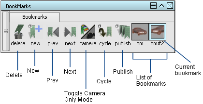

Bookmarks
As you work on the model, you typically change the camera view back and forth between two or more areas of interest. The NavBar lets you “bookmark” views of the model and return to those views by clicking the name of the bookmark.
Additionally, shading attributes (from the Diagnostic Shading panel or WindowDisplay > Hardware Shade), and annotations (created using tools in the Paint tab) are stored in bookmarks.
When switching from one bookmark (or view) to the next, the camera is animated to take you smoothly from one view to another without getting disoriented.
Add a bookmark for the current view using the NavBar
  1. Tumble, track, and dolly the camera to the view you want to save.
  2. Press + (also + on the Mac).
  3. On the NavBar, click and hold the Bookmark tool and select Add in the Bookmarks to add a bookmark for the current view. The bookmark is named BM. A number is appended to each bookmark created after the first one.
Edit a bookmarked view from the NavBar
  1. Press + (also + on the Mac).
  2. On the NavBar, click and hold the Bookmark tool and select Edit to open the Bookmark Lister.
  3. Release + (also + on the Mac) and do any of the following in the Bookmark Lister:
    • To change the name of a bookmark, hold down (Windows) or (Mac) and double-click the bookmark icon. Type a new name in the dialog box, then click OK.
    • To remove a bookmark from the list, click the bookmark icon, then click the Delete button (trash can) or drag it to the trash can icon by holding the .
View your bookmarks from the NavBar
  • Press + (also + on the Mac).
  • On the NavBar, click and hold the Bookmark tool and select the bookmark from the menu.
