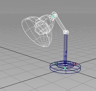

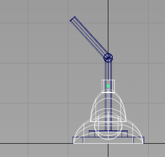

Position the lampshade
  1. Maximize the Left window.
  2. Choose Pick > Object and select the lampshade group.

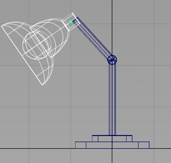

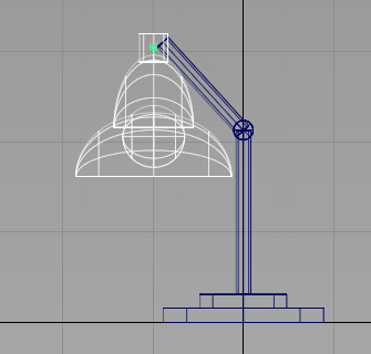

  3. Choose Transform > Move. Click and drag (away from the objects) to move the lampshade to the end of the upper arm.
  4. Rotate the lampshade about the y-axis. Choose Transform > Rotate and use the .

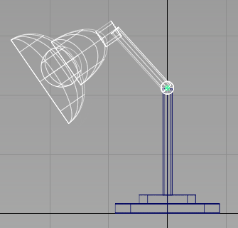

Group the lampshade and arm
Next, group the lampshade to the arm, so the lamp can be moved and arranged.

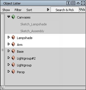

  1. Use Pick > Object and select the lampshade and the upper arm.
    The two groups are highlighted in the Object Lister.

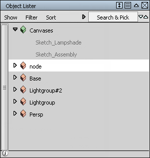

  2. -click on the selected objects in the Object Lister and choose Group from the drop-down menu (or choose Edit > Group).

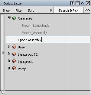

    A new node is created and displayed in the Object Lister.
  3. Rename the node Upper Assembly.

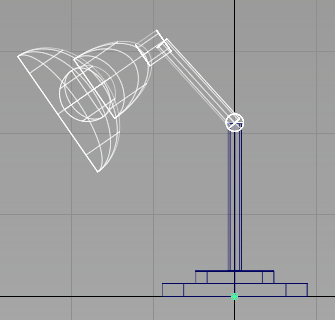

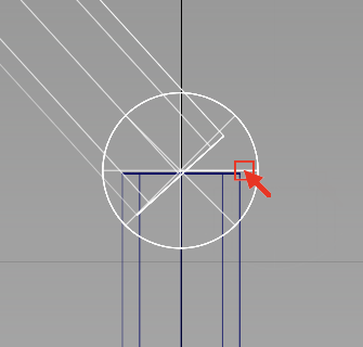

    The group is created with the pivot point in the default location, at the origin. To ensure that the upper assembly rotates correctly, move the pivot point to the center of the hinge.
  4. With Upper Assembly selected, choose Transform > Local > Set Pivot. Hold the and (Windows) or and (Mac) keys down and -click on the centerline of the hinge cylinder.
    The pivot point moves to the center of the hinge.
