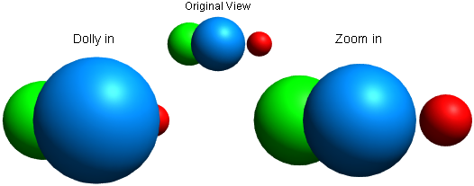

Zoom and Dolly
Both zooming and dollying change the size of all objects in your scene as they appear in the camera’s window. Dollying, however, also changes the size of objects that are near the camera relative to objects that are far from the camera. Zooming maintains the relative size of objects in your scene. By dollying, you are moving the physical location of the camera; by zooming, you are changing the focal length of the camera’s lens.

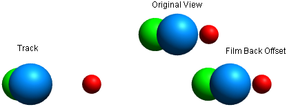

Track and Film Back Offset
Both tracking and changing the film back offset value change the position of all objects in your scene as they appear in the camera’s window. Tracking, however, also changes the position of objects that are near the camera relative to objects that are far from the camera. Changing the film back offset value maintains the relative position of objects in your scene.
