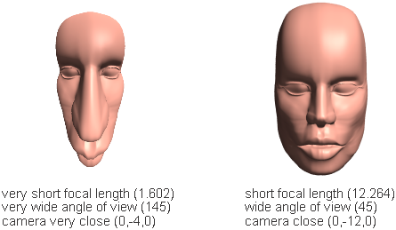

The Lens Properties define the properties of the current camera’s lens.
Focal length and angle of view are two different methods of defining the same lens property:
Lets you set the camera’s focal length either from a list of standard, real world focal lengths (between 15mm and 200mm), or by entering a value in the User Focal Length field (user). If you set Focal Length to user, the User Focal Length parameter becomes available. The default setting is user.
Lets you set the camera’s focal length by typing in any value. The valid range is 1 to infinity.
The horizontal angle of the view seen by the film. The valid/slider range is 0.2 to 179.
The angle of view is also known as the lens angle. It represents the width of the film back as seen through the lens, expressed as an angle.
The Angle of View value is related to the focal length value (either the Focal Length setting or the User Focal Length value), and the Film Back value:

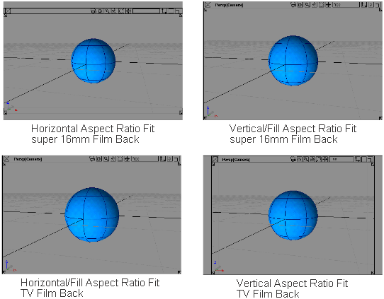

The Camera/Window Properties control how the camera’s view appears in the camera’s window.
Controls how the camera’s window displays the camera’s view. If the shape of the camera’s window is not the same as the shape of the camera’s Film Back, then the window’s display can fit the camera’s view in one dimension only (Horizontal or Vertical). The default setting is Fill which automatically fits the camera view in the camera window (in either the horizontal or vertical direction) so that the camera view fills the window

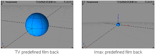

The Predefined Film Backs are standard film sizes that you can select for the current camera. Each predefined film back has a Film Back, Film Aspect, and Squeeze Aspect parameter; however, you can only edit the Film Back value (Alias does not use the Film Aspect and Squeeze Aspect values).
To select a predefined film back, simply click it. When you select a predefined film back, the Film Back values (under Film Back Properties) automatically change. To add a new predefined film back, click the Add button. To delete a predefined film back, select the film back from the list and click the Delete button. To edit a predefined film back, double click the field you want to edit, type in the new value, and press (Windows) or

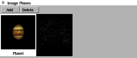

The Image Planes section of the Camera Editor contains a list of image plane swatches for the current camera, and buttons that let you add a new image plane to the camera or delete an existing image plane.
By default, a camera has no image planes, and no image plane swatches are listed. You can add one or more image planes to a camera using the Add button. The image planes are then listed in the Image Planes section of the Camera Editor, and the Image Plane Parameters for the active image plane become available. The active image plane is highlighted in white in the image plane swatch list. You can select an image plane by clicking on its swatch.
See Add or delete an image plane.
Lets you add a new image plane to the current camera by selecting an image file with the File Requestor.

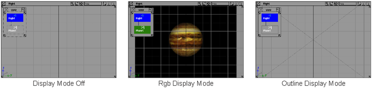

Controls how the image plane is displayed in the modeling windows and in the SBD window. The image plane will only render when Display Mode is either Rgb or Off. The default setting is Rgb.
Outline | A rectangle with diagonals. |
Rgb | Full 24 bit color image. |
Off | No display. |

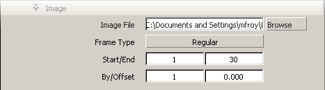

If you want to use a regular sequence of image files as an animated image plane (for example, if the sequence includes image files for frames 1, 2, 3, 4, 5,..., 30), set Frame Type to Regular. The Start/End and By/Offset parameters become available.
By setting these parameters, you automatically create an animation curve for the image plane’s Frame parameter which you can edit in the Action Window.
The first and last frame number of the image file sequence.
The increment of each image file frame number (By), and the frame of your animation at which the image plane displays the first image file of the sequence (Offset).
For example, if the image plane files are named image.1, image.2, ..., image.30, and the Offset value is 7, then image.1 is displayed at frame 1 + 7 = 8 of the animation, image.2 is displayed at frame 2 + 7 = 9, ..., and image.30 is displayed at frame 30+7 = 37. In addition, image.1 is displayed at frames 1 to 7 because it is the first image of the sequence, and image.30 is displayed at frames 38 to the end of the animation because it is the last image of the sequence.

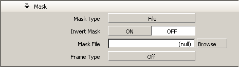

Image plane masking is similar to label masking (see Mask a label using an image file mask).
The Mask parameters let you mask the Image File so that only portions of the image are visible.
The method used to mask the image plane’s Image File. The default setting is Off (no mask).
Off | no mask; the entire rectangular Image File is displayed |
Image | the mask is taken directly from the Image File (for example, if the image contains transparency information) |
File | the mask is taken from a separate image: the Mask File (see File Mask Type below) |
Chroma-Key | the mask is based on a certain color, or a certain range of colors, in the Image File (see Chroma-Key Mask Type) |
Reverses the effect of the mask so that masked areas become unmasked, and vice-versa. The default setting is OFF.
If you want to use a separate image file to mask the image plane’s Image File, set Mask Type to File. The Mask File and Frame Type parameters become available.
The name of the image file used as a mask by the image plane. Where the Mask File is white, the Image File will be visible. Where the Mask File is black, the Image File will not be visible. Where the Mask File is grey, the Image File will be partially visible. The Mask File is automatically positioned in the same location as the Image File.

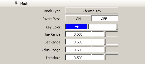

If you want to mask certain colors, or a certain range of colors, in the Image File, set Mask Type to Chroma-Key. The Key Color, Hue Range, Sat Range, Value Range, and Threshold parameters become available.
One use of chroma key masking is to mask out the blue background of live action that was filmed against a blue screen.
The color to be masked in the Image File. The default color is RGB 0,0,255. To mask a range of colors, you must also set the Hue/Sat/Value Range parameters.
The range of hues (H) centered on the Key Color which will also be masked. The slider range is 0 to 1. The default value is 0.5.
The range of saturations (S) centered on the Key Color which will also be masked. The slider range is 0 to 1. The default value is 0.5.
The range of values (V) centered on the Key Color which will also be masked. The slider range is 0 to 1. The default value is 0.5.
The point at which the color state changes. The slider range is 0 to 1. The default value is 0.5.

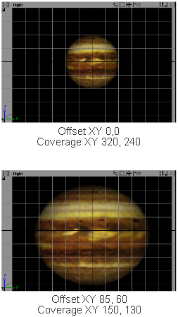

See Sizing and positioning an image plane.

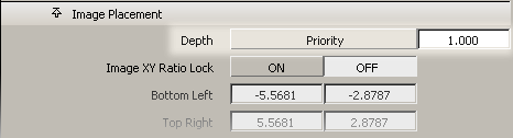

The Image Placement parameters control how the Image File covers the camera view. For example, you may not want to display any bad edges that may be in your Image File, or you may want the image to occupy a very specific region of the screen.

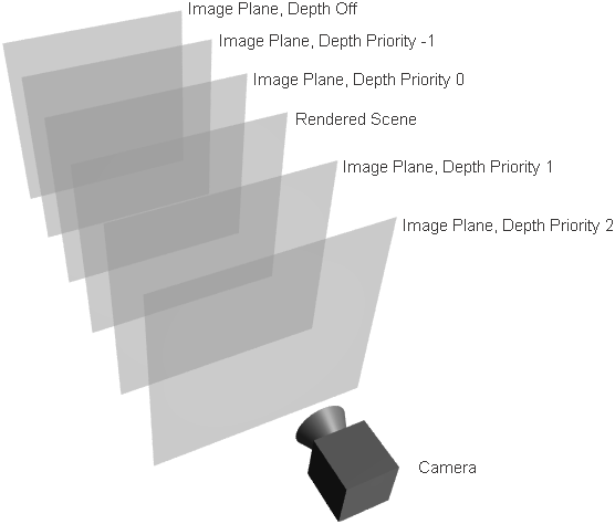

Determines whether the image plane appears in front of or behind your scene, and in front of or behind other image planes. If Depth is Priority, a numeric field becomes available.
The value of the Priority numeric field determines the order the image planes appear in. Image planes with Priority greater than 0 will appear in front of the rendered scene. Image planes with Priority less than or equal to 0 will appear behind the rendered scene.
Maintains the image plane’s proportions by keeping the Bottom Left and Top Right values at a constant ratio. The default setting is OFF.
The position of the bottom left corner and top right corner of the image plane measured in world units.
The horizontal and vertical size of the image plane measured in world units.
The horizontal and vertical resolution of the image plane measured in pixels per world unit.
Tiles (repeats) the image horizontally (Wrap Horiz) or vertically (Wrap Vert) when the coverage area is larger than the size of the image. The default setting is OFF.
The origin of the image plane relative to the origin of the Image File.
The horizontal and vertical dimensions of the image plane relative to the Image File.
