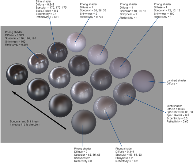

    As you can see from the following image, all of the shading parameters of each shader affect the appearance of the image-based lighting.
