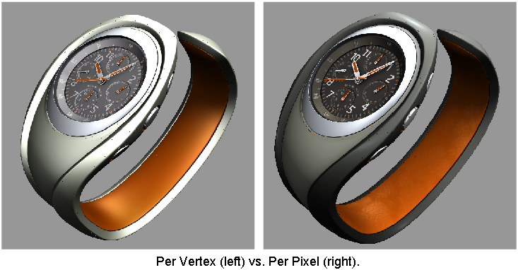

Per vertex provides you with the same quality of shaded mode as was available previously in Alias. Choose Per vertex for a fast approximation of the surface while modeling. Per pixel provides highlights close to the look obtained with the RayCaster, and requires a graphics card that supports this mode. For further information about qualified graphics cards, see http://www.alias.com/qual_charts/.

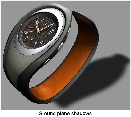

Self-shadows boost the realism of a scene by adding additional information about spatial relationships of objects, and provide information about the shape of an object as it casts shadows on itself.
Self shadows must be turned on in the Hardware shade settings window. This is the master control that determines whether any self-shadows can be cast.
Use self-shadows with either ALL LIGHTS or SELECTED LIGHTS to have control over the shadows based on the lights’ parameters, position, and rotation.
To select which specific lights can cast shadows, use the Light editor’s Cast Shadows button in the Active Effects section. The light editor shadow settings are shared with the software renderer.

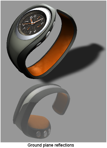

Enables ground planes, ground plane shadows, and ground plane reflections in hardware shade mode. Options are found in the Ground Plane section of the Environment editor.

If enabled, ground plane reflections are approximated while camera operations (track, dolly, tumble) occur, and are updated when the mouse button is released.
