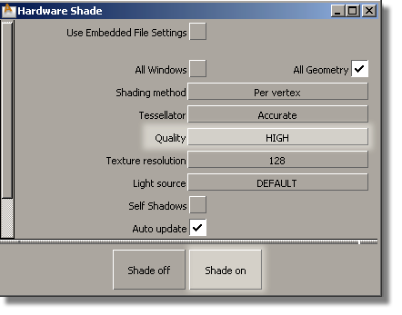

To preview an animation without reducing the scene
  1. Open WindowDisplay > Hardware Shade .
  2. Set Tessellator Quality to HIGH to increase the quality of the shading. Then, click the Shade On button to turn on shaded mode.
    The model is displayed in shaded mode.
    Tip:
    If you want to adjust your view, first turn off shaded mode, then move the camera using the hotkeys or the icons in the view title bar. (The camera moves very slowly when you are in shaded mode.)
  3. Play back the animation.
  4. Choose WindowDisplay > Hardware Shade to turn off shaded mode.

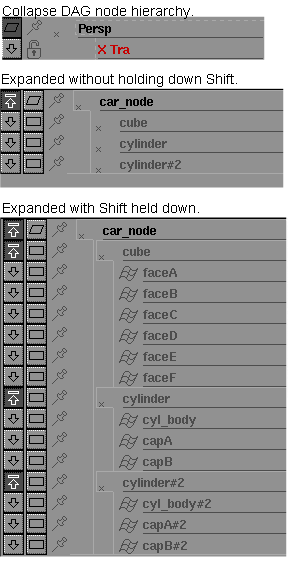

Expand a DAG node in the action lister
How to expand a DAG node in the action lister.
If a DAG node is grouped above a hierarchy of other DAG nodes, you can display its descendant nodes by clicking the expand item button next to the node. If you want to expand the complete hierarchy down to the leaf level, hold and select the expand item button.
