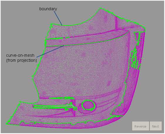

Create a collar NURBS surface along any boundary of a mesh, or curve-on-mesh.
The collar surface is fitted to the mesh along the selected curve (edge or otherwise) and provides continuity information along that curve, allowing you to build additional geometry from it.
A curve-on-mesh results from projecting a curve on a mesh, or intersecting meshes.

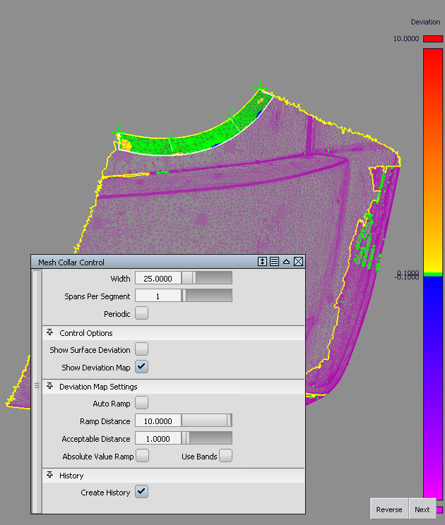

Create a collar surface against a mesh
All the mesh boundaries, and curves-on-mesh, are highlighted in green.

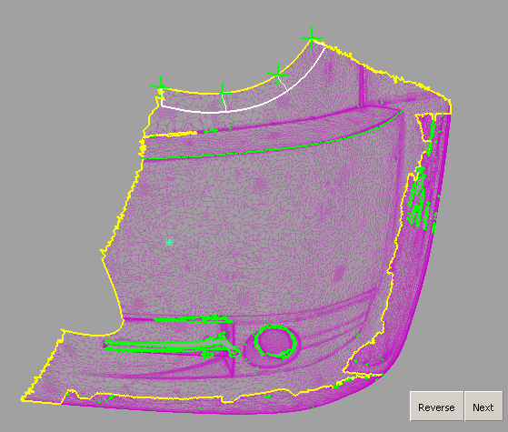

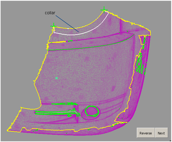

A collar surface is built along the curve, covering the shortest distance between the two points.

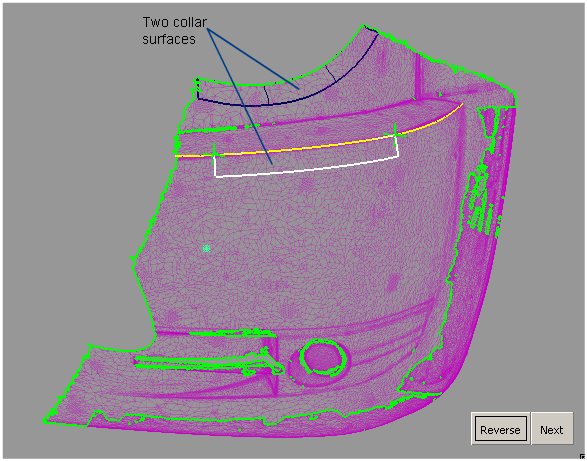

On a curve-on-mesh, the Reverse button flips the collar to the other side of the curve, instead of changing its direction.
The collar is fitted to the mesh along its entire width, as well as along the selected boundary or curve-on-mesh.
Collar surfaces are degree 5 in the U direction, and degree 3 in the V direction, by default.
You can then use NURBS modeling tools on the edge of the collar surfaces to build additional surfaces against the mesh.
