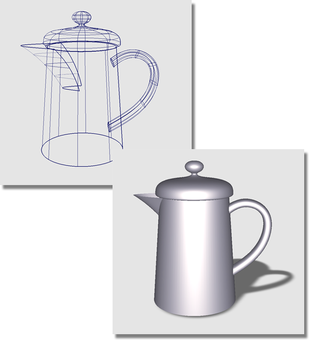

The main body and lid of the coffee pot in the following images are created using a revolved surface. The handle is an extrusion and the spout is a skin surface. Notice that the components are intersecting and have not been fully detailed. This level on detail is acceptable for a concept model. Detailing techniques are described in the tutorials that follow.

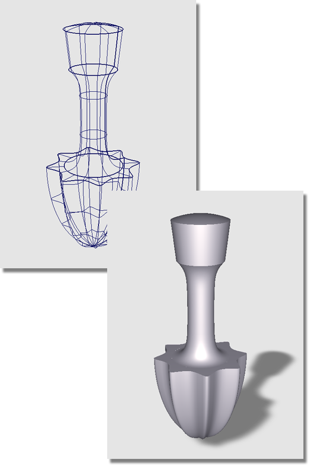

Continuing the kitchen theme, the lemon squeezer handle is built from revolved surfaces. The squeezer was sculpted from a simple revolved shape. The number of spans was increased, to allow for the number of grooves, and alternate rows of CVs were scaled inwards.

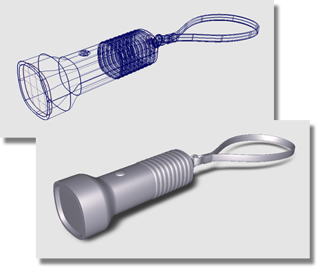

The flashlight in the following image is based on a circle which has been shaped to a smooth square shape. Skin surfaces have been used for the main shape, with extrude surfaces used for the grip detail and the lanyard.
