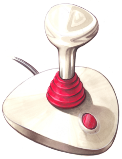

In this tutorial, you model a computer joystick. You are introduced to tools that enable you to build surfaces from curves. As well, you start to use layers to organize your work. Finally, you learn a way to view and evaluate your work.
