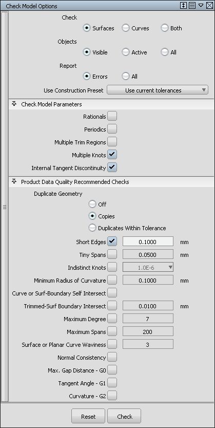

  1. Choose Evaluate > Check Model .
    In the Check Model Options window:
    • Choose whether to check only Surfaces, only Curves or Both.
    • Choose whether to check All objects, All Visible objects, or the picked (Active) objects.
    • Choose whether to list only objects with problems (Only Errors) or all objects.
    • Choose a set of construction tolerances from the Use Construction Preset drop down menu, to use in the model check calculations.
      Note:
      These correspond to the Construction Presets available from Preferences > Construction Options. Select Use Current Tolerances to use whatever preset is already selected in the Construction Options window (indicated by a white arrow).
  2. Choose what types of problems or conditions you want to check for. See Evaluate > Check Model for more information on the different checks.

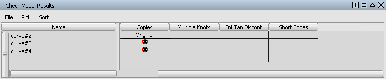

Check for duplicate curves or surfaces
You can check for both copies (exact duplicates), and duplicates within a given tolerance. Copies have the same CVs, same knots, and same degree (such as geometry created with Edit > Copy and Edit > Paste ).
Checking for copies
    This is the fastest of the two methods.
  1. Set Duplicate Geometry to Copies in the Check Model Settings option window.
  2. Click Check.
    The report window displays a column titled Copies tohelp you identify all the copies. If Report is set to All, the original geometry is identified by the word “Original” in the column.

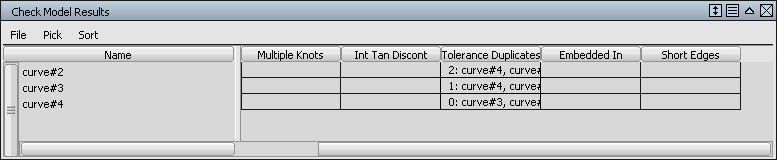

Checking for duplicates within a given tolerance
  1. Set Duplicate Geometry to Duplicate Within Tolerance in the Check Model Settings option window.
  2. Adjust the Duplicate Tolerance value. Geometry that is a duplicate of, or embedded into other geometry within this tolerance will be reported.
  3. Click Check.
    The report window displays two columns titled Embedded In and Tolerance Duplicates tohelp you identify all the duplicates. The duplicates prefixed by “0” in the Tolerance Duplicates column are considered the originals.

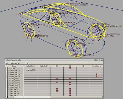

Check continuity between curves or surfaces
  1. Turn on the Max. Gap Distance - G0, Tangent Angle - G1 or Curvature - G2 option in the Check Model Options window.
    Note:
    Tolerances for these continuity checks are found in the Tolerance:Continuity section of Preferences > Construction Options and correspond to the construction preset selected in the Check Model Options window.
    Note:
    For the G0 test to be successful, you must also ensure that the Topology Distance tolerance (Tolerances:Topology section under Preferences > Construction Options) is larger than the Maximum Gap Distance.
  2. Click Check.
    The report window displays columns titled G0, G1 and G2 with marks indicating failure. If geometry fails the G0 test, higher continuity tests for G1 and G2 will not be performed. Similarly, if geometry fails the G1 test, continuity test for G2 will not be performed
    In the viewing window, the boundaries that failed the continuity tests are shown as thick yellow lines with a letter identifying the type of discontinuity (P = positional, T = tangent, C = curvature).

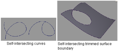

Check for self-intersections
This check enables you to identify curves, surface boundaries, or trimmed surface boundaries that contain interior self-intersections. A self-intersection refers to the curve or surface boundary intersecting itself at one or more locations that are not both endpoints (see pictures below).
  1. Turn on the Curve or Surf-Boundary Self Intersect option.
  2. Click Check.
    The report window displays a column titled Self-Intersecting with marks indicating failure for the objects listed in the left-hand column.
