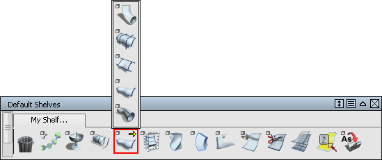

Create a cascade in a shelf
Create cascading menus on your shelves by adding items above other shelf items.
  1. Using the middle mouse button, drag an item to the top part of another item already on a shelf.
    A large red arrow head pointing up is displayed.
  2. When you see the up arrow, release the mouse button.
    A confirm box appears, displaying a default name for the new pullout.
  3. Type in a new name, then click OK.
    The new item is placed above the existing one.
  4. To use the cascading menu, click the shelf item, and drag up to the item you want to choose.
