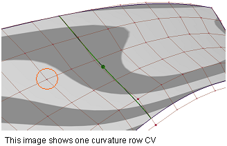

For example, in V12.0, the third curvature CV could be moved freely, yet the curvature evaluation might have stayed within tolerance. For example, as long as R1 and R2 were larger than 10 centimeters and 1/R1 – 1/R2 was less than the tolerance of 0.1, changes could be made to the third curvature CV without breaking the curvature continuity.
In contrast, in V13.0 onward, curvature continuity checking is more sensitive and flags errors more strictly.

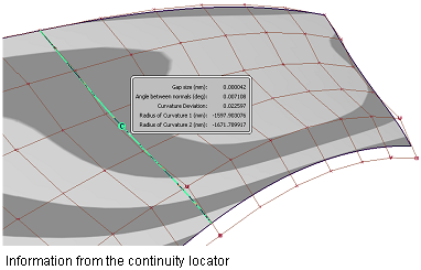

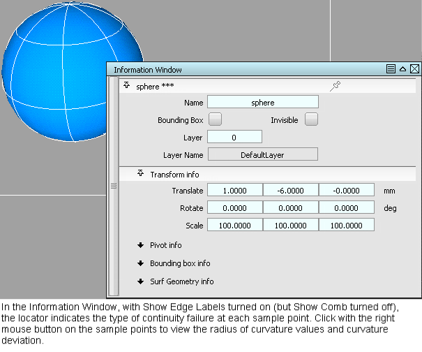

When Show Edge Labels is turned on (in the Surface continuity tool or Information Window), clicking with the right mouse button on the sample points of the locator shows you the radius of curvature values and the curvature deviation. The number of sample points can be increased by dragging the middle mouse button up or to the right, and decreased by dragging down or to the left.
The radius of curvature values along the boundary depend on the direction in which the curvature is measured. The direction used in Alias is perpendicular (90 degrees) to the common boundary between the surfaces.

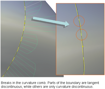

In the Surface continuity tool, or Information Window, turn on Show Comb to display the curvature comb. The curvature comb may appear broken as shown in the following image. This indicates that there is a change in the type of continuity failure, and is helpful when working with individual CVs.

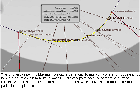

When a relative calculation for curvature continuity deviation is used, as one radius keeps increasing, the curvature deviation tends toward the value 1.0.

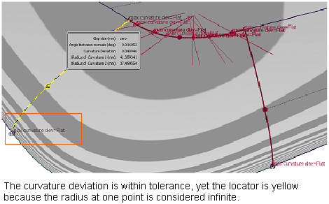

This is not necessarily a visual curvature problem, but it is necessary to inform you that the radius of curvature on one of the surfaces is approaching an infinitely high value. A purely flat surface is one which has an infinite radius of curvature; therefore this condition is flagged as FLAT. A radius larger than 100000 centimeters is considered infinite. The curvature evaluation shows a yellow locator labeled FLAT only if the radius is infinite on one surface across the common boundary, and not infinite on the other one. If both radii are infinite, then the curvature deviation tends toward zero and the curvature evaluation check passes.
Seeing such a failure condition (as indicated by the color of the continuity check locator) does not mean that there is a noticeable curvature break. It just means that there might be a potential problem and you should use other diagnostic tools, such as highlight lines (zebra stripes), curvature combs on sections, and so on, to decide if the result is acceptable.
