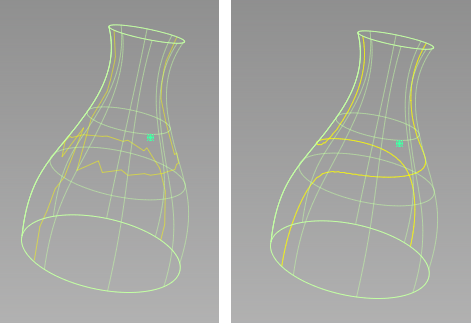

Display Tolerance
When Visual is checked on, this value defines the quality of the visual curves independently of the tessellation tolerance. This lets you set the visual tolerance to a smaller value to get better quality visual curves, without reducing the tessellation tolerance used for shading.
Left: visual tolerance = 0.1 mm. Right: visual tolerance = 0.001 mm
