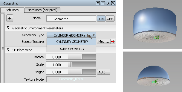

  4. In the editor, choose Geometric in the Environment section. This opens the Geometric Environment window.
  5. Click the Map button next to the Source Texture field to open the Texture editor.

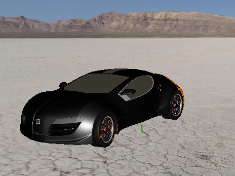

  8. Choose WindowDisplay > Hardware Shade ❒, turn on the Show Background option and click Shade On.
    The geometric background appears. When you rotate and pan the view, the environment texture file moves with the model.

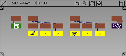

To adjust the shape, position, and size of the geometric environment texture
The background image is mapped to either a Dome or a Cylinder (depending on the Geometry Type chosen in the Geometric Environment window) that surrounds your model. This geometry cannot be directly manipulated or rendered; you must use the Rotate, Scale, and Height sliders to transform it.
Scaled down texture node showing the shape of the environment geometry.
The geometric texture has an associated texture placement node that also lets you move, scale and rotate the environment (using the usual Transform tools) to adjust it around your model.

  3. Double-click the Hardware Shade tool in the Control Panel or choose WindowDisplay > Hardware Shade in the menu.
  4. In the option window, turn on Show Background and click the Shade On button.
    The geometric background appears around your model.
