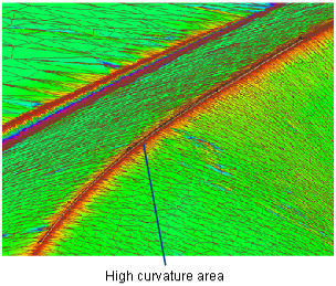

  1. Turn on the Curvature Evaluation shader from the Diagnostic Shading panel.
    This will show you areas of high curvature where you may want to create sharp edges.

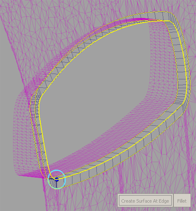

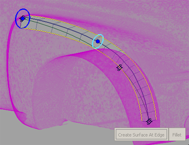

  4. Select the curve
    A blue radius manipulator appears at the start of the curve.

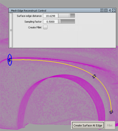

  5. Adjust the radius through the option window (Surface edge distance) or by dragging the mouse on the blue circle.
    Tip:
    Make sure the tube defined by the curve and radius is large enough to encompass the area where you want to build the sharp edge. That is, the outer edges of the tube should lie in the flatter mesh regions (green on curvature map).

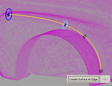

  6. If necessary, you can click along the curve to create extra radius manipulators and adjust them with the mouse.
    This creates a variable-radius cylinder and controls the shape of the surfaces.

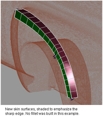

  7. Click the Create Surface At Edge button.
    Two NURBS skin surfaces are produced, creating a sharp edge where they meet (at the theoretical intersection). The underlying mesh is removed.
    Tangent lines show you where the tube intersects the mesh.

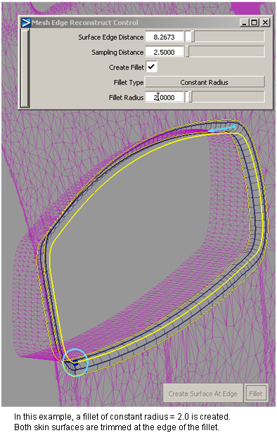

  8. If the Create Fillet option was turned on, click the Fillet button to create a fillet between the two surfaces.
    The surfaces are trimmed back to the edges of the fillet (where possible).

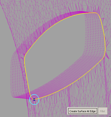

  4. Select a curve along the common boundary between the two meshes.
  5. Adjust the radius through the option window (Surface Edge Distance) or by dragging the mouse on the blue circle.

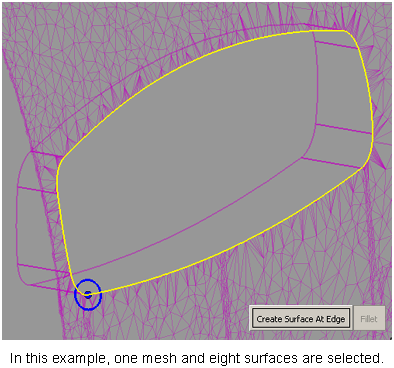

To reconstruct the edge between a mesh and one or more surfaces
  1. Choose Mesh > Mesh Edge Reconstruct .
  2. Select one mesh, and one or more surface(s).
    The mesh must have been previously intersected with the surfaces and all geometry trimmed/cut to the intersection so that only their edges touch.
  3. Click the Accept button.
  4. Select a curve along the common boundary between the mesh and surface(s).
    This creates a variable-radius cylinder and controls the shape of the resulting surface.
    A single NURBS skin surface is produced on the mesh, creating a sharp edge where it meets the existing surface(s). The underlying mesh is removed.

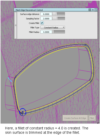

  8. If the Create Fillet option was turned on, click the Fillet button to create a fillet between the surfaces at the sharpened edge.
    The surface is trimmed back to the edges of the fillet (where possible).
