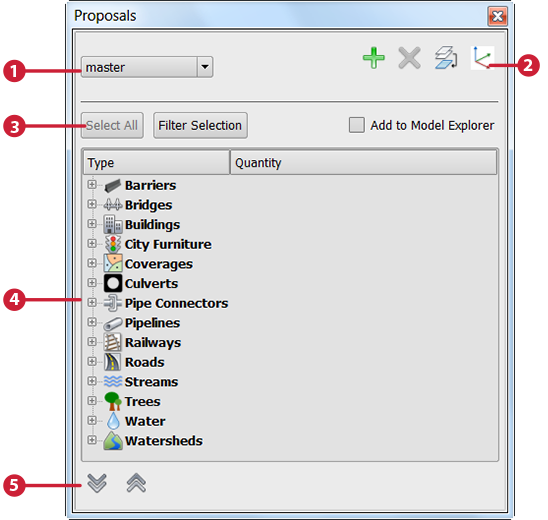

The elements in the Proposals Manager panel are:
| Icon | Name | Description |
Add New Proposal |
Add a proposal to the master. The new proposal is based on the previous one: it initially contains all the same features as the proposal that was active when you added it. All proposals are stored with the master—think of them as different views of the same data. |
Remove Current Proposal |
Delete the current proposal. Any features you created in that proposal are also deleted. |
Merge Proposals |
Merge two proposals, combining their changes. If any of the features conflict, the conflicts are outlined in red. To delete the conflicts, select the relevant objects and press Delete. Once you decide on a final proposal, you can merge it with the master. See To merge proposals. |
Toggle 2D/3D Sketch Display |
Switch between viewing in two or three dimensions. |
To select all features that you added to the current proposal (either by sketching or by importing), click Select All. If you have a current selection set that includes proposed features as well as master features, click Filter Selection to show only the members of that selection set that you added to the current proposal. |
By default, proposed features appear in the Proposals Manager, but not in Model Explorer. To add proposed features to Model Explorer, highlight them and select Add To Model Explorer. Note: Once features are added to the Model Explorer, you cannot remove them from the Model Explorer. Removing them in the Model Explorer removes them from the model altogether.
(Expand All) and
(Collapse All) arrows to display each data source or collapse the list to show only feature type titles. Once you collapse the list, you can expand individual feature types. Right-click any data source to see relevant options.
