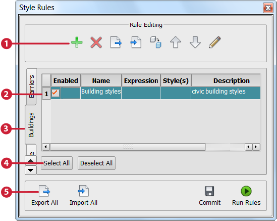

The elements in the Style Rules panel are:
| Icon | Name | Description |
Add Rule |
Creates an empty rule for the current category. Double-click the rule to display the Rule Editor, where you define the rule. For more information, see Define Style Rules. |
Delete Selected Rule |
Removes the selected rule from the Style Rules Panel. You can re-import it if you need it again. |
Save Selected Rules |
Saves all selected rules to an XML file that you specify. You can import the rules using the Load Rules option. |
Load Rules |
Imports style rules from the XML file you specify. The rules are added to the current category of the Style Rules Panel. |
Copy Selected Rule |
Duplicates the current style rule to the current catalog. Use this option to create a new style rule that is similar to the one you are copying. The copy appears in the preview area. Double-click it to make your changes. |
Move Selected Rule Up/Down |
Moves the selected rule up or down one position in the list. Rules are applied in the order that they appear in the list. |
Edit Selected Rule |
Opens the Rule Editor, where you can define or edit a rule. For more information, see Define Style Rules. |
Export All |
Saves all rules of all rule types to an XML file that you specify. |
Import All |
Loads rules for all rule types from an XML file that you specify. |
Commit |
Saves changed rules of any rule type to the database. |
Refresh |
Saves changed rules of any rule type to the database and also initiates a regeneration of the model. |
