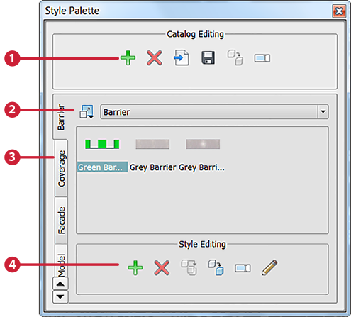

Drag a style from the preview area onto a feature to apply that style. For more information, see Override Style Rules.
The elements in the Style Palette are:
| Icon | Name | Description |
Add New Style Catalog |
Creates a style catalog that is stored in an XML file in a location you specify. It is added to the Style Palette and becomes the current style catalog. |
Delete Selected Style Catalog |
Removes the current style catalog from the Style Palette. You can re-import it if you need it again. |
Import Style Catalog From File |
Imports a style catalog from the XML file you specify. It is added to the Style Palette and becomes the current style catalog. |
Copy Selected Style Catalog |
Duplicates the current style catalog. The copy is stored in an XML file in a location you specify. The copy becomes the current style catalog. |
Rename Selected Style Catalog |
Lets you enter a new name for the current style catalog. |
to change the size of the previews that display the contents of the catalog. A slider lets you change the size dynamically. When you click a tab, the current style catalog changes to the first available catalog for that category.
Add New Style |
Creates a style within the current catalog. A blank style entry appears in the preview area. Double-click it to specify the style. For more information, see To add a material style. |
Delete Selected Style |
Removes the selected style from the current catalog. |
Copy Style To Another Catalog |
Copies the selected style to a catalog within the current category. For example, use this option to copy a barrier style from one barrier catalog to another. |
Make a Local Copy |
Copies the selected style to the current catalog. Use this option to create a new style that is similar to the one you are copying. The copy appears in the preview area. Double-click it to make your changes. |
Rename Selected Style |
Lets you enter a new name for the selected style. |
Edit Selected Style |
Opens the Style Editor, where you can change the properties of the selected style. For more information, see Edit Styles. |
