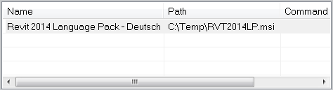

  3. When creating the deployment, use the Include Additional Software option to specify the language pack.
    Example:
