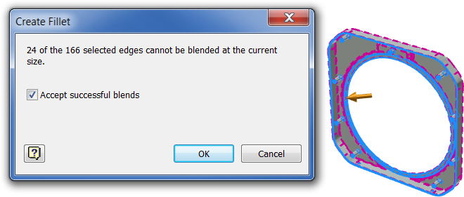

Fillet success
In previous releases, if one edge in a fillet selection set failed, the entire fillet operation failed. In this release, any blend failures open a dialog box with the option to fillet the successful edges.
After you fillet the initial edge selection, you can repeat the operation using the same size radius. This action usually blends more edges.
In the model used in the following image, an additional 17 edges are filleted after the first 142 edges are successfully filleted.
