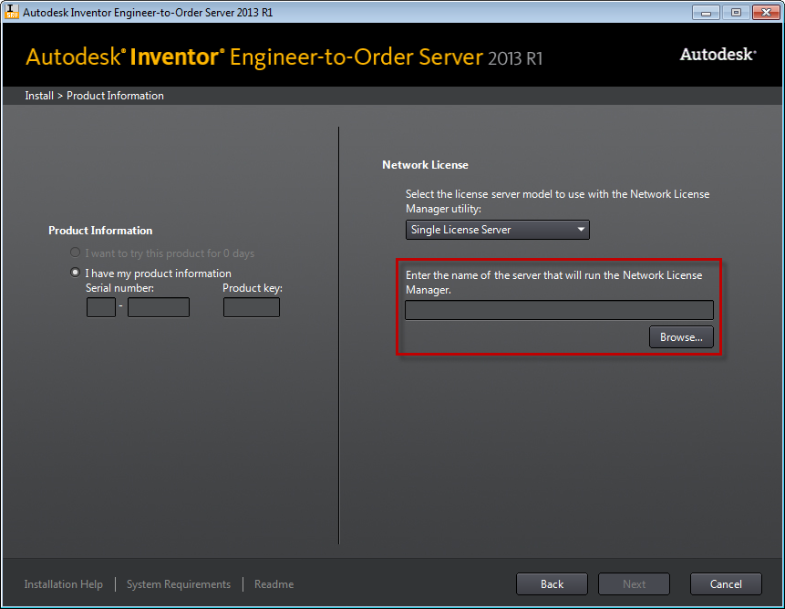

  1. Launch the ETO Server installer, and select Install.
  2. On the next page, accept the license agreement, and click Next.
  3. On the Product Information page, enter the license information. Enter the name of the server that you select in Network License.
