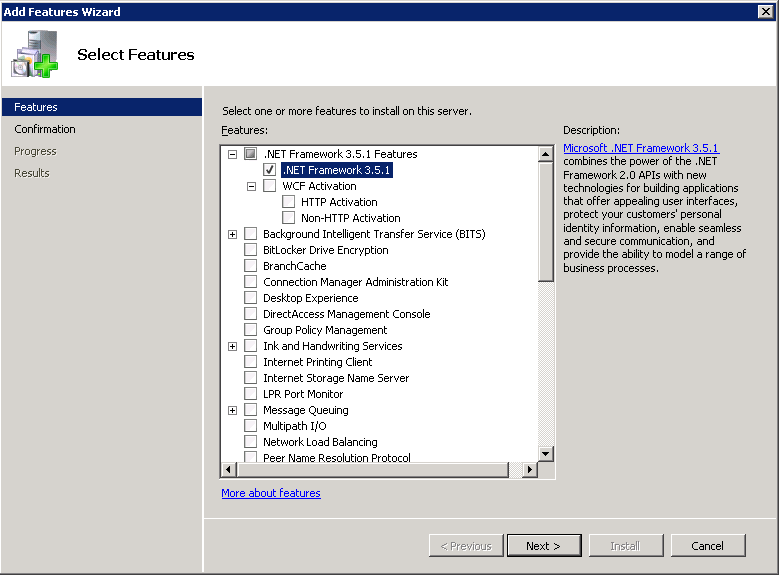

When Installing ETO Server on Windows Server 2008, install the .NET Framework 3.5.1 Feature through the server manager before you install ETO Server.
