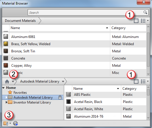

Improved navigation in the Material Browser
New to the browser:
1. Show/Hide library panel and tree icon give you greater control over your view.
2. Home button to control the display of your saved libraries.
3. icon provides more access to Library operations.

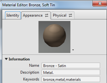

New tabbed interface in the Material Editor
Navigate easier within the Material Editor dialog box using its new tabbed interface. In this interface, you can distinguish the various material assets and their properties.

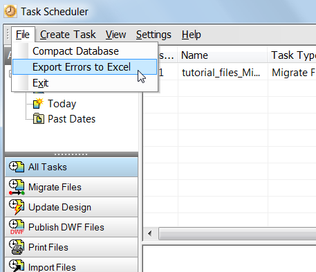

Export errors from Task Scheduler log file to Excel
Task Scheduler generates log files in .mdb format to report task errors. You can export the log file entries of one or more tasks from the Task Scheduler .mdb file format to an Excel spreadsheet.
The Excel file generates a separate sheet for each error type. The first column of each sheet lists the error files. The second column lists the corresponding task names.
Export Errors to Excel is available on the Task Scheduler File menu, and on the context menu for a selected task.
