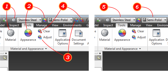

The Material, Appearance, Adjust, and Clear Overrides access points are:
  1. Accesses the Material Browser. Use for creating and modifying materials.
  2. Accesses the Appearance Browser. Use for creating and modifying appearances.
  3. Activates the Adjust command. Use for modifying assigned appearances.
  4. Accesses the Clear Overrides command. Use for removing appearance overrides.
  5. Assigns the specified material to the selection set.
  6. Assigns the specified appearance to the selection set.
